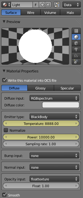

Not bad. I thought you need to animate the temperature of the black body. E.g. for glowing effect or something. I think your camera set to autofocus. Just switch it off and adjust the focus and depth of field manually.oneeyedfox wrote:I took my time and read through forum about animation and colours export to octane I better understand that now but I have little problem again I render animation of 100 frames or so and couple frames are rendered defocused,I used default camera settings.my first render https://www.dropbox.com/s/8gr4w6dx3sbtj0p/0000-0083.avi

Add: Per-material OCS export option
1.19.6 -
