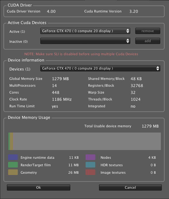

Hi everyone!
I've just made a litle upgrade to my setup.
GTX 470 is perfectly running in Mac Pro under Mac OS X 10.6.7. (after some tweaks with Multibeast) 448 cores working smooth.
I had unpluged my gtx285... both connected (one to motherboard other via molex>6pin connector) was too much for PSU... or maybe I should get 6pin Y-splitters to power it properly.
Little manual for all of you cheap bastards like me :) others go and buy two quadro 4000 ;) :
1. Install Multibeast from http://www.tonymacx86.com
2. Unplug power cables from Mac ready card (gtx285) and plug in GTX 470
3. boot & pray
4. install tonymacx86 NVIDIA Update 2.0
5. reboot & pray more
6. got GTX470 on mac os x but no CUDA!
7. open terminal and run: cp /Library/Frameworks/CUDA.framework/Versions/A/Libraries/libcuda_256.01.10.dylib /Library/Frameworks/CUDA.framework/Versions/A/Libraries/libcuda_256.02.05.dylib
8. do some octane renders faster than ever and with little black apple in upper left corner of the screen.
