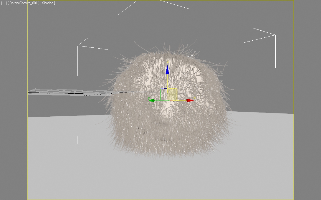

When using a WSM modifier the modified object gets displaced see picture, here with hair fur modifier, but any will do the same thing unless the object is placed in the middle; Z0,Y0,Z0
//Daniel
