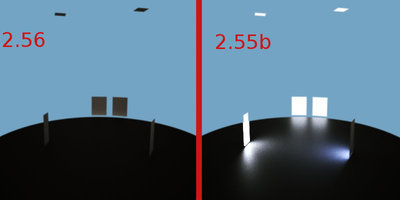

matej wrote:Emissions don't work for me in this release. I opened a scene created in 2.55b and none of the emitters work. Even if I re-create an emitting material in 2.56, still nothing.
Did anyone else (on Linux) experience such behavior?
We checked on Linux, and emitters work as expected. Do you have a scene you can send us which exhibits the problem?

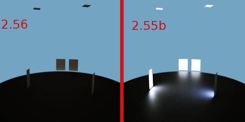

Hi, I tested emitters on the preview ball and a new simple scene and they indeed work in 2.56. But when I open some project in 2.56 the emitters don't work. So I stripped that project scene down to only the emitting planes and tested it in both versions. The scene is attached below.
emit-scenaA.zip
(24.92 KiB) Downloaded 188 times

matej wrote:Hi, I tested emitters on the preview ball and a new simple scene and they indeed work in 2.56. But when I open some project in 2.56 the emitters don't work. So I stripped that project scene down to only the emitting planes and tested it in both versions. The scene is attached below.
Hi, thanks for sending the test scene. We could find the problem, and we may do an update to 2.56 solving this.
