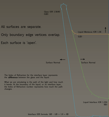

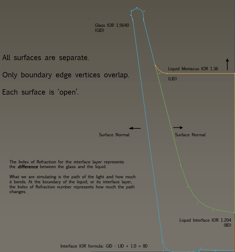

PhilBo's description has one detail wrong -- he says that the IOR for the interior liquid layer should be glass + liquid / 2. The average IOR. That's incorrect, and if I'd thought about it I would have figured it out. Instead I looked at my photo and monkey-grabbed the sliders until things looked more right, then tried to figure out why.
See this diagram:
-Zak Jarvis

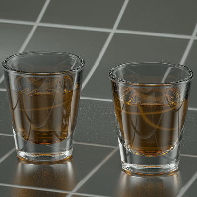

The comparison shot is taking longer than expected. Rendering both models in the same scene was introducing a ton of noise and just generally looking crappy. So I'm redoing it as separate images that more closely match my shot glass photo.
Early on I said I didn't have the patience to do a 1:1 photo-to-render comparison, but it's looking more and more like I'm doing just that. I guess I had to sneak up on it to make sure I still thought I was playing instead of doing work.
As for all the different techniques, there's a surprisingly small number of people who really chase these things down to the minute details and there's a surprisingly large number of ways to implement dielectrics, and then there are a ton of variables within each implementation.
Attached is the very noisy comparison image.

- Stromberg90
- Posts: 48
- Joined: Sun Jan 17, 2010 12:59 am
I have seen other topics on this aswell at other forums, but they never seem to get to an answer
In the newest rendering i still feel the left one looks most correct, to my eye atleast.
And i love these kind of expriments
