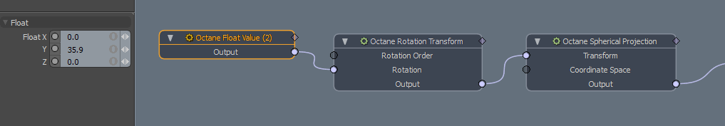

How do I gain nodal control over this input? As opposed to inputting the number manually, I'd like to connect a node to control this value.
Use an Octane Rotation Transform.

It's odd I can plugin a Float Value node into the 'Octane Rotation Transform' node, but it won't plug into the 'Octane Transform Values' rotation input.
Yes - that's because internally the Octane Transform Value is actually a transformation matrix, not 3 floats (in the Rotation Transform case).

Makes sense. I was assuming the Octane Transorm Value might allow it because you can breakout the separate channels in the rotation matrix (and scale and translate) ie:
matrix breakout.jpg (37.96 KiB) Viewed 6051 times
In any case, it's all working.. many thanks.

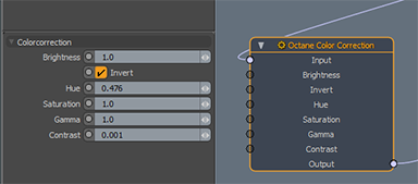

Hi Paul, getting some strange results with the nodal environment (Use RGB Color)
When you have an image node in a material in the Shader Tree, the plugin does some calcs to set the Octane Gamma to the Modo Gamma according to the Scene 8 and 16 bit colorspace. However, this color space conversion may not be happening for the Environment IBL. If you have the Scene 8 and 16 bit colorspace as sRGB, is your problem resolved? What color space setting do you have on your Modo scene?
Paul
rrbarb
Posts: 91
Joined: Wed Feb 26, 2014 1:40 am
Just a default Colour Correction node, no values have been changed
I work in the Octane Setup window so when I add nodes the input fields for them are already there.
Color Correction
Color Correction
Invert flips axis
Hue:
Hue (1/360) * targetDegree
Can also use negative values
./rrb

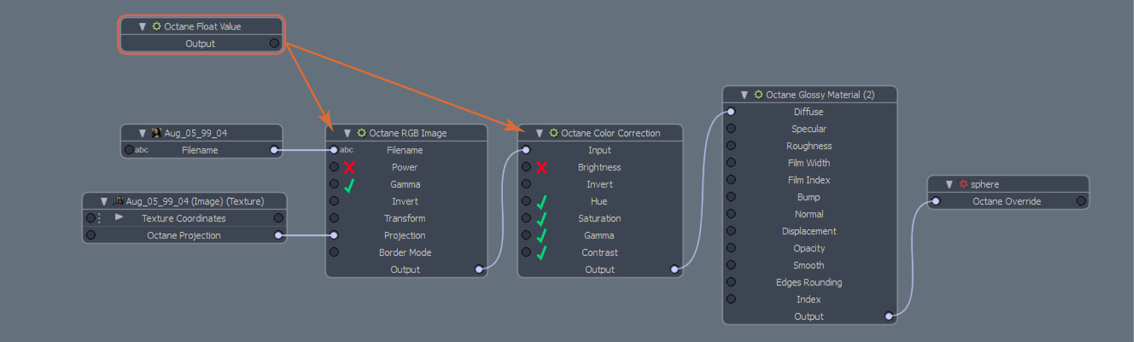

Hi Paul I'm having more issues with Octane nodes.
I'm trying to drive a couple input values using the float node, but it doesn't work for a couple of inputs, namely:
Octane RGB Image ---> Power
Octane Color Correction ---> Brightness
The Octane Float refuses to plugin to either of these inputs and tells me 'Invalid Pin Connection' and to check the log. It works with the other inputs such as hue, saturation, gamma, contrast but not with those 2 mentioned above.

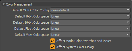

Paul
Colourspace in Modo is something I've never looked at until now, and my setting appear to all be at 'Linear'. Hopefully this is the settings dialog box you were referring to:
If I change the 'Default 8-bit Colorspace' and 'Default 16-bit Colorspace' to sRGB. nothing seems to happen and the render looks the same.
