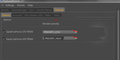

Hi momade,
thanks for your explanations!
Anyway I'm not sure if I understand right.
First, if both cards are exactly the same model with same driver:
how can I find out, which card is which?
Is the first card in settings the card in the first pci-slot?
Second.
So assumed if the first card is the card where the monitor is plugged in (so also for OS),
Priority "Low" means that Octane uses this card less?
So I would think, that if I want to use the second card only for Octane,
I should set the priority for this 2. card to "maximum", not?
thanks
MIke

sorry, I'm really too stupid to understand!
When the first titan is the one with the monitor plugged in:
This is, how I understand and would set this up, because I want
Octane to use full power of the second card.
Wouln't it be easier to understand, if each card has the option for
priority "low", "medium" or "high"?
Then I would check for the fist card --- "low"
and for the second card I would set it to -- "high"
sorry for this confusion!
Mike

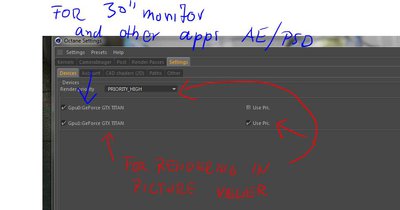

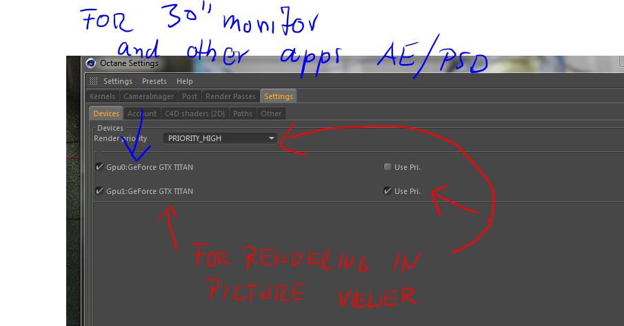

rodross
Posts: 135
Joined: Fri Jun 27, 2014 3:01 pm
Miohn, basically, if you uncheck "use Pri." on your card NOT running your OS and monitors, it will run at full, maximum speed in Octane. Check the "use Pri." for your other card and set the priority dropdown to low or medium so you can use other programs. If you have it setup that way and your OS is lagging horribly, then you need to reverse the settings in Octane and uncheck "Use Pri." for the other card and check it for the one that was running maximum. You're probably right, it may be useful to have priorities separated for both, but people who run multiple GPUs tend to not use priority for the secondary so that it is always running at maximum.

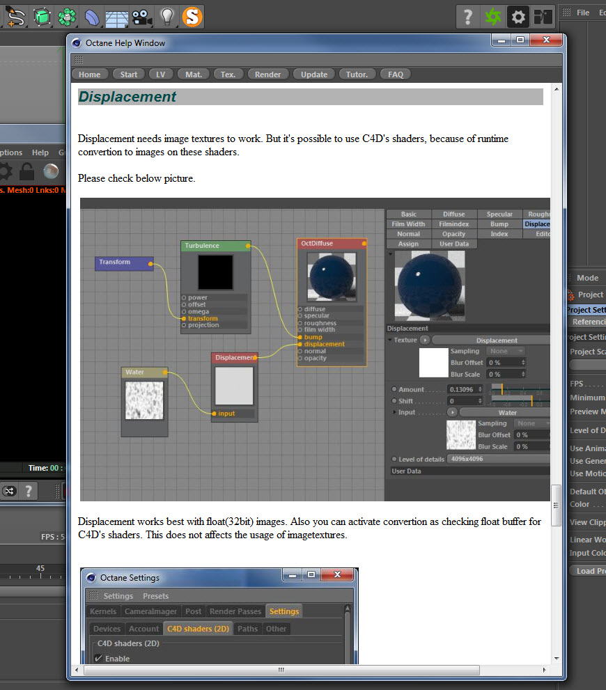

Thanks for report. But, neither is a bug. For displacement refer the attached image and help window.

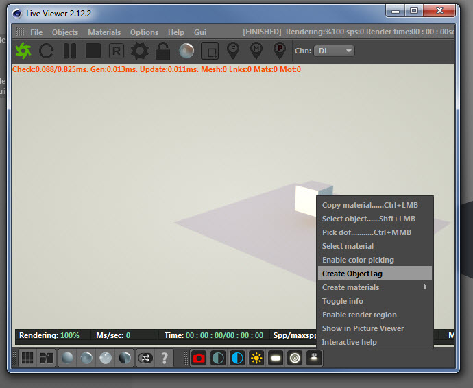

if we talk about double geometry, when you send the tagless objects will be exported as a collected mesh. When you add a objecttag to a object, this object will be exported a single mesh under the different geo. group. But old data will be there. This is your scenerio. So you should resend this scene to generated clean export data. But if you add a object and put a objecttag, this will not generate double geometry. Because it would not be sended before.
Ok, why we don't send all data? Because sending is a slow process. Expecially for high poly counts. So we don't do it automatically. I hope this is clear for you.
EDIT: Forget to mention. Check second image to see a method. There is a "create objecttag" menu item. Which creates tag and resend the scene again. Worth to know.
