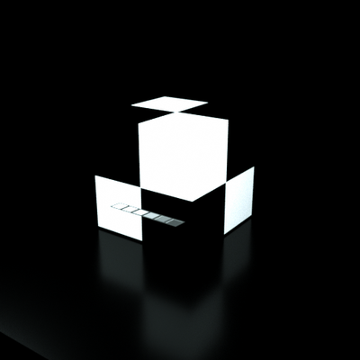

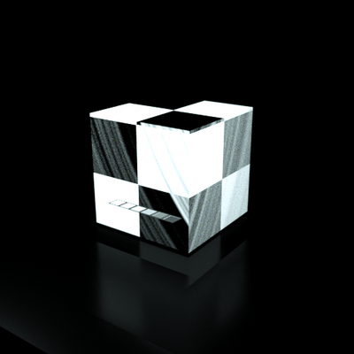

Just started a new test scene with a cube
Octane is rendering it ok, my previous scene now crashes octane.
On this cube scene I applied a checker texture to the cube, at 100% scale on the texture the cube renders fine with the checker texture. From 100% to 55% there is not change in the size of the texture.
From 50% to 1% the texture changes its size but renders with artifacts if you change the scale in a large amount from say 50% to 25%.
if you scale to numbers other than 50% 25% 12.5% ,10% 6.25% 5% 2.5% then you are fine there is no artifacts, those number cause artifacts
I'm getting lots of Octane crashes aswell. After Octane crashes I can no longer render the scene even after a Modo restart.
Here are some samples

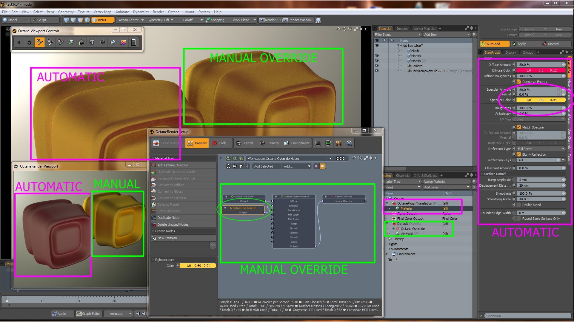

Paul, latest plugin getting really nice! thanks for all the hard work. Material conversions are still a bit confusing, but I have been able to get some more or less matching results in modo/octane.
Might I suggest... why not have a shader dialog within modo to define the values you want in Octane, but where the appropriate modo shader settings are set?
IOW - a dialog with all the settings for the 3 octane shader modes. set for diffuse, and set all the values within the dialog - then that pipes those values to the modo shader. Not that there would be any math to it, just a dialog with the shader controls arranged (perhaps with tooltips, and explanations) such that they make sense when trying to achieve an effect.
for example - if I want to change the IOR for my reflection in a glossy material in Octane, but not have to create an override... how do I do that?? glossy materials aren't transparent, so the IOR is grayed out hmmm....
Basically the idea here is to reveal, within the UI, the conversion rules, and make it easier to make modo shaders that more or less look like octane shaders without having to override everything. Basically I'm just suggesting a UI to edit the modo settings by way of octane-like controls. So you can get the exact octane result you want in modo that would translate then to octane as closely as possible. It would be a UI that leaves out unsupported features, and groups shader settings so it's obvious what they control. Otherwise - perhaps the translation rules should be included in the manual... e.g. in the material descriptions in them manual for each type of octane material, explain in the description how to get that material from a modo material. And for each octane material setting, list the settings/math of how you are translating it to the octane shaders.
EDIT:
Am I doing something wrong, or is Specular % being applied to the grayscale default specular amount? Since modo can apply a color to the specular,
I would expect the specular translation to be modo(Specular% * Specular Color) --> octane(Specular:RGB Color)

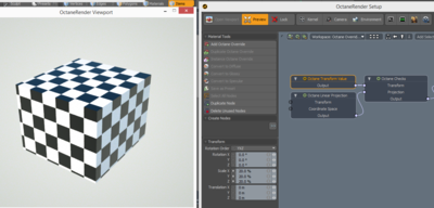

The Checks texture does not work correctly at the scene original. Move it off 0, 0, 0. See http://render.otoy.com/manuals/Revit/?page_id=165.On this cube scene I applied a checker texture to the cube, at 100% scale on the texture the cube renders fine with the checker texture. From 100% to 55% there is not change in the size of the texture.
This sounds like you have a video card issue. Are you running out of VRAM? Have you applied the fix in the FAQ of the manual? Have you overclocked your card?I'm getting lots of Octane crashes aswell. After Octane crashes I can no longer render the scene even after a Modo restart.

I'm not sure I completely follow you here. The conversion rules for converting Modo materials to Octane materials are at http://render.otoy.com/manuals/Modo/?page_id=35. IMO, If there is something about the material that you need to change, you are better off overriding the Modo material with an Octane Override and tweaking it there then adjusting the Modo material.Might I suggest... why not have a shader dialog within modo to define the values you want in Octane, but where the appropriate modo shader settings are set?
I think the coversion rules from the manual do this already?Basically the idea here is to reveal, within the UI, the conversion rules, and make it easier to make modo shaders that more or less look like octane shaders without having to override everything. Basically I'm just suggesting a UI to edit the modo settings by way of octane-like controls. So you can get the exact octane result you want in modo that would translate then to octane as closely as possible. It would be a UI that leaves out unsupported features, and groups shader settings so it's obvious what they control. Otherwise - perhaps the translation rules should be included in the manual... e.g. in the material descriptions in them manual for each type of octane material, explain in the description how to get that material from a modo material. And for each octane material setting, list the settings/math of how you are translating it to the octane shaders.
Yes, the specular converts as a greyscale, not RGB color. It can be changed, however the feedback received so far indicated people wanted it as a Greyscale so that you could edit that pin within the Material node (rather than as a separate RGB Color node).EDIT:

Move the cube a fraction off the center of the scene (ie. off 0, 0, 0). To adjust the checks scale, use the Scale sliders on the Transform pin of the Checks node.On this cube scene I applied a checker texture to the cube, at 100% scale on the texture the cube renders fine with the checker texture. From 100% to 55% there is not change in the size of the texture.

You say that feedback so far says that people dont want their specular color to be reproduced? I dont understand. Many materials need colored specular... How about translate it to grayscal value if the color is 100% white and an rgb color if its anything else. I dknt see the value of ignoring the specular color. If i set an rgb specular color in modo i want an rgb specular color in octane period. And i dont want to have to set up an override for two dozen materials that come in from clients that dont have octane for modo. I want as LITTLE work as possible to render from an already set up modo scene to an octane rendered scene.face_off wrote:Thanks though i could t find it before - i must have been looking at an outsated manual. I looked through that whole section.The conversion rules for converting Modo materials to Octane materials are at http://render.otoy.com/manuals/Modo/?page_id=35. IMO, If there is something about the material that you need to change, you are better off overriding the Modo material with an Octane Override and tweaking it there then adjusting the Modo material.
Still reading it just now i found it to be a bit confusing.
