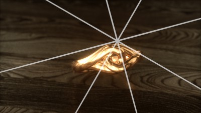

I am rendering now a seuqenze with 650 frames with bloom and glare effect. Randomly i get frames like this. This is very weird! Also using bloom / glare and using object id tag makes render manger crash like we had it with 0.72b. I mean the hung up problem! If you need further information skype me!
Kind regard Chris!
