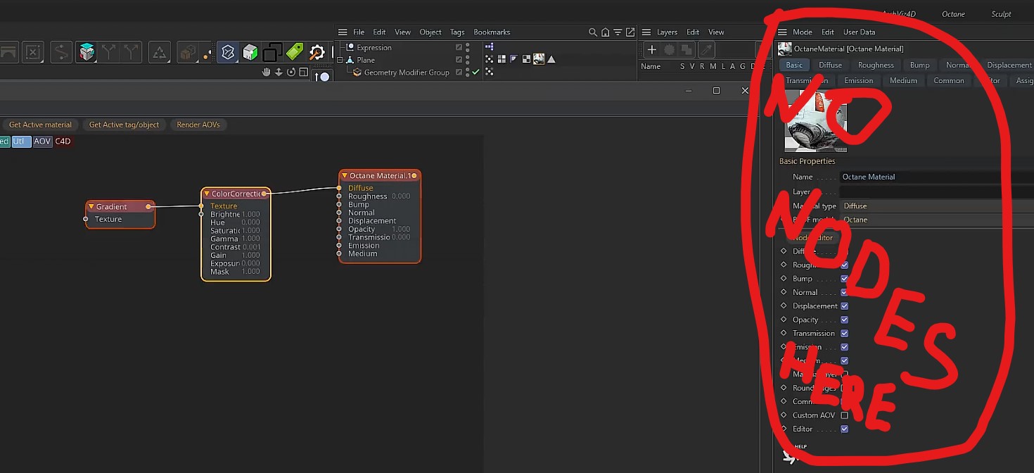

Unfortunately this stopped to work from some time. Individual nodes inside Ocatne material are not show anymore in material manager - only main Octane material. I tried with "edit controls" disabled too

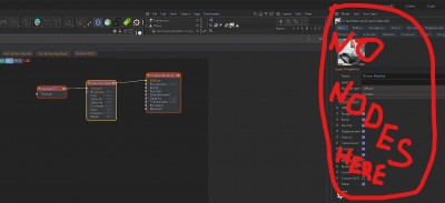

aoktar wrote: Which nodes for example? All nodes should be draggable, can you show me some example? I didn't understand what you show in the video
Every nodes. They stopped to trigger C4D attribute manager to show Octane nodes. They visible only inside Octane node window but without caption to drag.

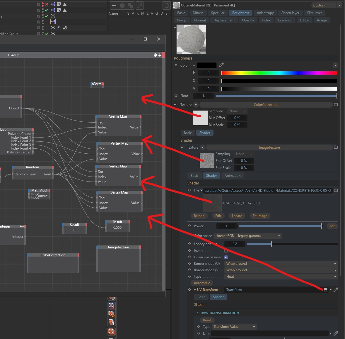

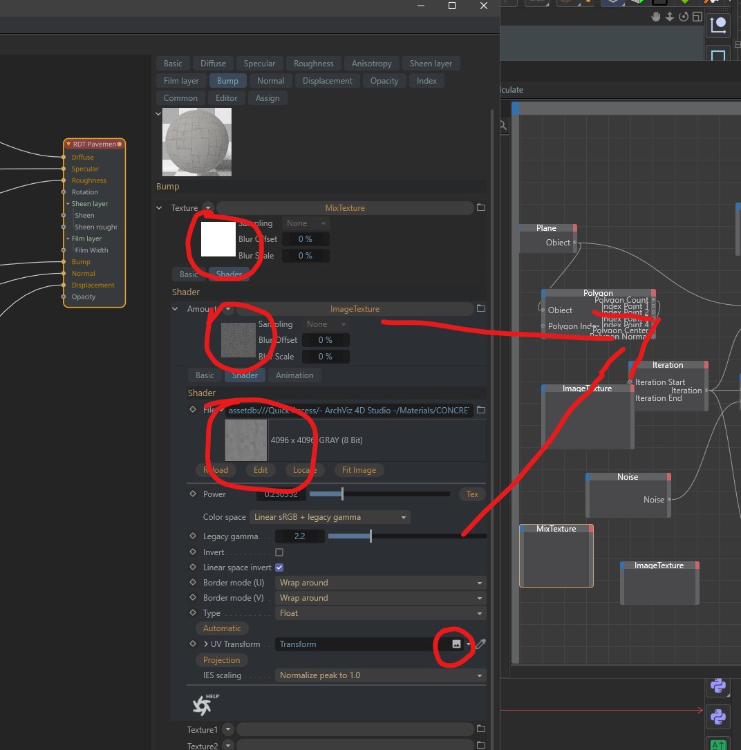

Ok I found solution but I think that it works different than before now. Node doesn't show in C4D Manager until I click for its icon preview also I must drag node preview icon or its window name from manager to xpresso.
nodes_to_xpresso.zip
(323.76 KiB) Downloaded 142 times
In that way any node can be dragged to Xpresso.

Generally I mean that every node even Transform from deep nodes hierarchy can be moved to Xpresso from C4D Attribute Manager window and from "Edit Controls" window from Octane node editor using these squared node previews and little image icons :
It works even for very deep hierarchy and special nodes like OSL so no need to use xpresso set driver and creating temporary xpresso tag, copy-paste
