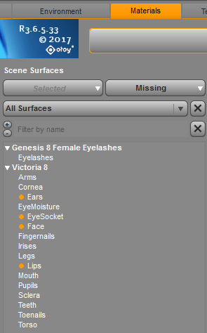

Having a problem with Victoria 8, the eyelashes are now a prop and they also include part of the EyeMoisture, however the plugin doesn't have the EyeMoisture surface under that prop, only under V8, so it gets rendered with a default grey material.
I am aware of this issue - and looking into it.

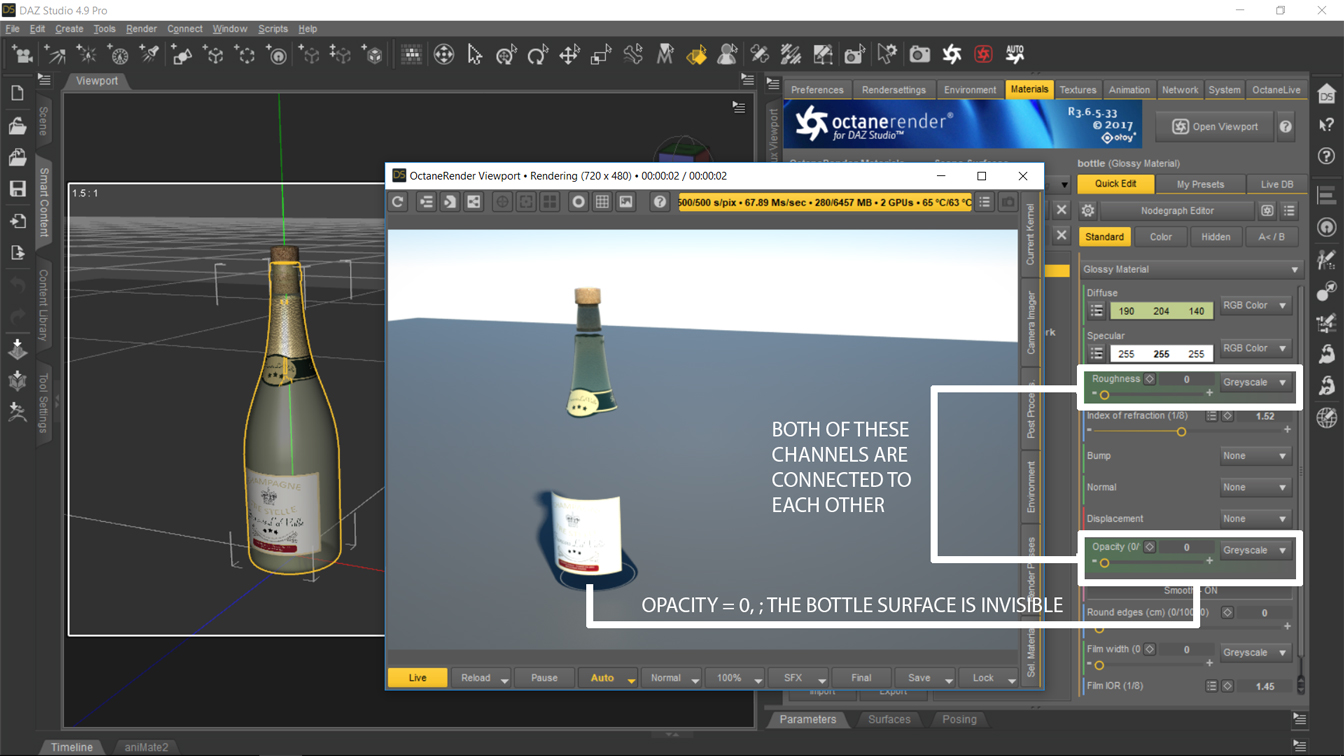

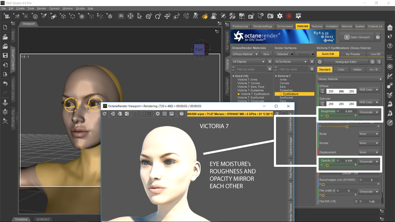

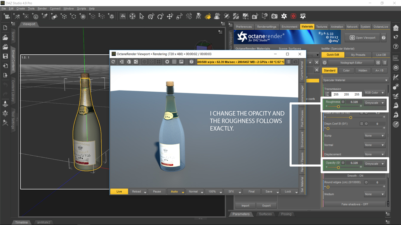

Hi Paul,
Opacity and Roughness are connected to each other, meaning changes to one is mirrored to the other exactly.
It doesn't seem to affect all objects; this bottle prop happens to have the issue, as well as most Genesis3 characters' EyeMoisture for me.
Pls ignore what I said about having to change the material type to specular first to encounter this issue; it seems to affect surfaces that are converted to Glossy or Specular from the get go.
As you can see in the screenshots:
in #1 The bottle surface originally has Glossy material, I haven't changed anything to the surface's material settings at this point,
in #2 I change the material type to Specular, the issue remains. I tweak the Opacity slider and the Roughness slider follows exactly and vice versa.
in #3 is the same issue affecting Victoria 7's EyeMoisture
I could not reproduce this issue with V7. I can you show me the DAZStudio shader for EyeMoisture? And can also send a screenshot after you click Nodegraph Editor for the EyeMoisture material pls?
