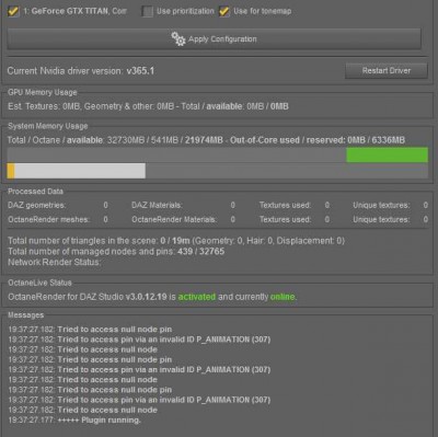

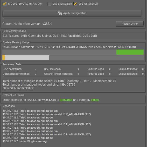

Any reason the plugin shows v3.0.12.19 is activated and currently online after installing this update?
My error - the version number (19) was not updated. But you are on the right version. I will fix the Octane Log error too...
