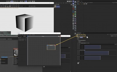

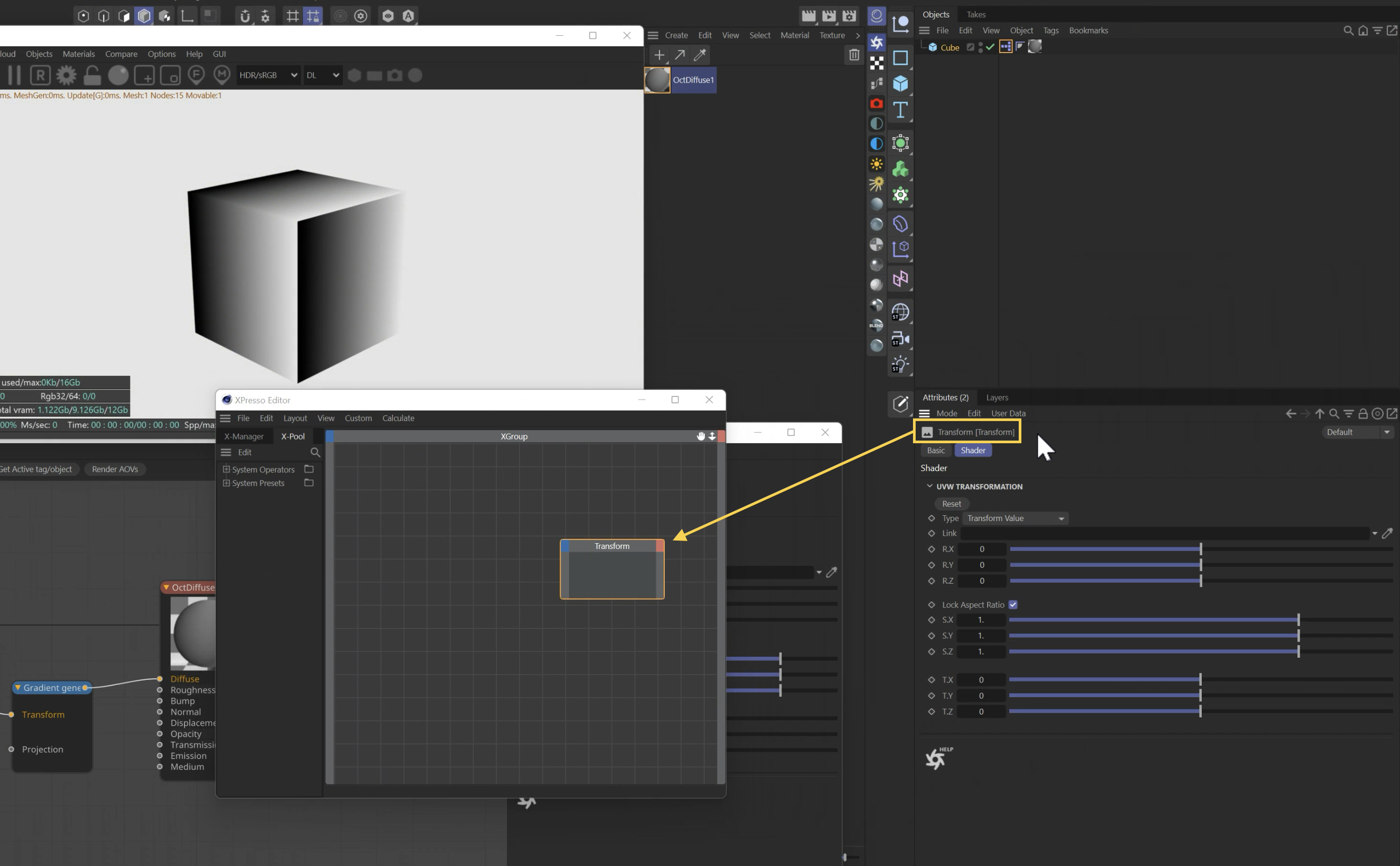

For Xpresso, you can drag & drop the little node icon from Attribute Editor into Xpresso editor:

bepeg4d wrote:For Xpresso, you can drag & drop the little node icon from Attribute Editor into Xpresso edito
Yes but as I said from some version nodes stopped to show in Attribute manager only in node editor window even if I have disabled them there.

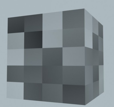

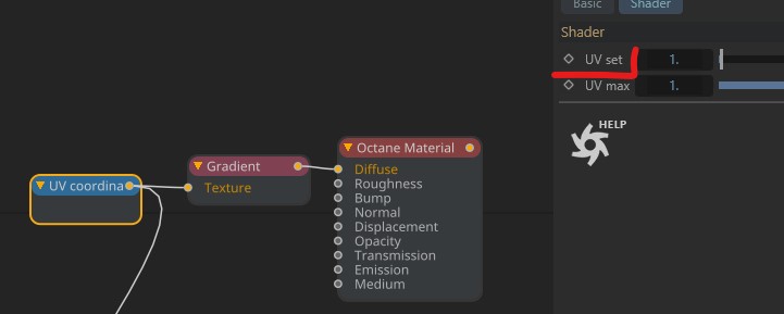

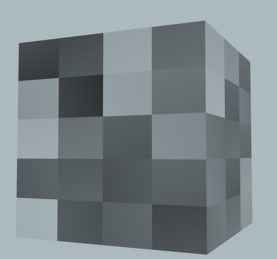

Does this UV set feature works ? I have two UVs in object and I'd like one of them to use with UV coordinates node connected to gradient for randomizing colors per polygons but I can't get this UV Set to work.
It works only for first UV.

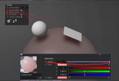

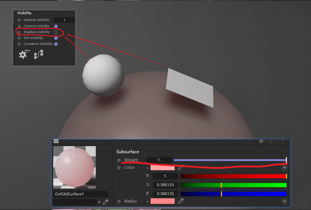

`I have a question about the standard surface material. If the subsurface is enabled, other objects cannot be excluded from casting shadows.We hope that you can fix this issue.Thanks!
Posts: 16068
Location: Türkiye

For UV sets, we have only one is usable at the moment. Rest two is reserved for different purposes.

nuc7ear wrote:`I have a question about the standard surface material. If the subsurface is enabled, other objects cannot be excluded from casting shadows.We hope that you can fix this issue.Thanks!
just drop an orbx to illustrate the issue.

aoktar wrote:you can drag from material manager
Unfortunately this stopped to work from some time. Individual nodes inside Ocatne material are not show anymore in material manager - only main Octane material. I tried with "edit controls" disabled too
