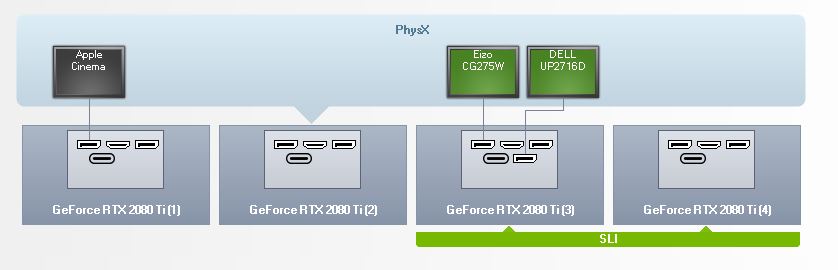

Dear Karu,
It seems only one pair of 2080ti sli is allowed by nvidia, the second pair does not appear in the nvidia control panel at the same time with the first pair,
does that mean octane may jump over the nvidia control panel to active the both nvlinks?
only one pair of sli is actived at the same time

jimho wrote: It seems only one pair of 2080ti sli is allowed by nvidia, the second pair does not appear in the nvidia control panel at the same time with the first pair,
NVidia drivers at the time of writing this allow just a single pair of NVlinked cards for GeForce series, more than one pair is allowed just for Quadro cards.

Thanks for the explanation
