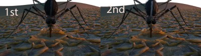

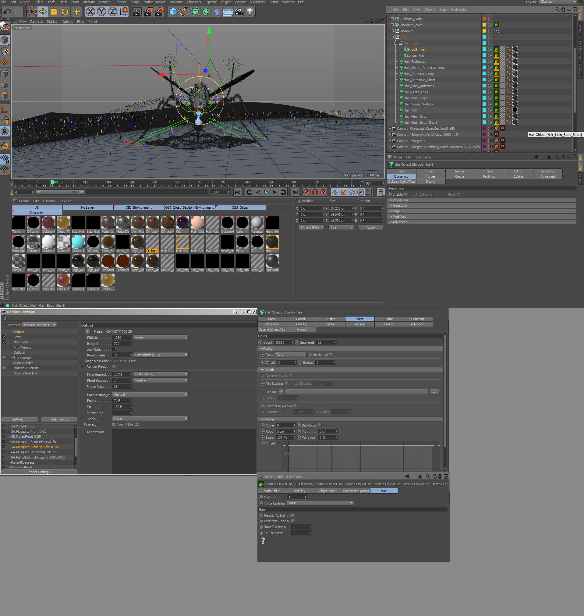

First of all, thank you for the latest updates, the Octane Scatter is wonderful! I have a weird problem with the latest plugin version which I didn't have before. I have a mosquito model with hairs on it, different parts of the body with different hair objects and settings. The problem is that after the 1st frame from whatever sequence I'm rendering octane only renders the guides and no inbetween hairs. The 1st frame is ok, all the hairs are there bu the following are only showing the guides. I have put the hair objects on animation priority 499, dynamics are disabled, the Hair Renderer from the render settings is gone(with it activated no hairs were rendered), tried different videocards( tried on a machine with 6x980ti and one with 1xtitan x and 1x780ti). Also, in this scene I'm using Octane Scatter for the "skin scales" with vertex distribution. In the Live Viewer it always looks ok the hair, I had no problem but in Picture Viewer, after the 1st frame is rendered, it goes wild. I have attached a screenshot to better explain my problem.I also sent you a link with the project scene and textures so you can have a look for yourself. It's a pretty complex one but I need to find a way to render it :-s.
I am using C4d R17 032 and .
Thank you, hope you can help.
Hair Problem
Hair Problem
Hair Problem
Hair Problem
