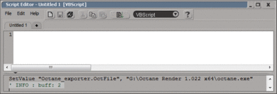

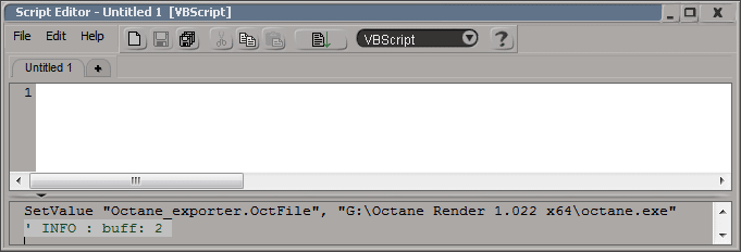

Try to change the octane_64.dll with the one from the zip in the folder:
C:\Users\xxx\Autodesk\Softimage_2011\Addons\Octane_Exporter\Application\Plugins
before you start Softimage.
octane_x64.zip
(82.37 KiB) Downloaded 274 times
Then start Softimage, run the addon under File->Export->Octane_exporter
Choose the Octane Execute under the Project Configuration, open the script editor and tell me, what you see.
You should see "' INFO : buff: x" where x is any value, tell me that value.
