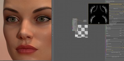

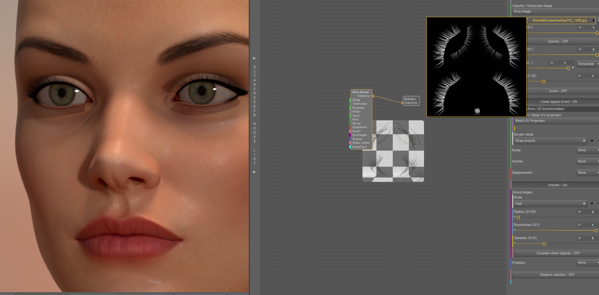

While I was able to fix the issue in the sample scene. The same problem occured in another scene, where the coherent ratio is set to "0", so no coherent ratio at all.
Yet, the eyelashes are being rendering with a shadow, where there should be none. Please see the screenshot attached.
PS: rajib's problem, four posts above mine, is pointing towards the exact same issue. There definitely seems to be something wrong within the rendering of opacity within materials with mediums.

your model has bad eyes
