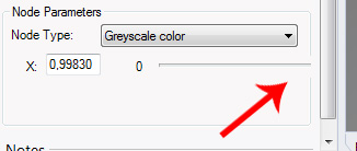

Hi Paul,
I tried to install the last version of octane for rhino 6. I have some trouble with slider and values of material node. Is it an octane problem or rhino 6 problem?
This is a video I made:
http://s000.tinyupload.com/index.php?fi ... 6248876692
Another problem is that sometime I can't see the maximum value on the slider
I have a win 7, 32 gb ram, gtx 1080 ti and a monitor with a resolution of 1920x1080
bye
bye
- Attachments
- MATERIAL 2.jpg (26.77 KiB) Viewed 8114 times
This video shows a known issue. I am about to release a test version (regular version, not subscription) which will hopefully fix this.I tried to install the last version of octane for rhino 6. I have some trouble with slider and values of material node. Is it an octane problem or rhino 6 problem?
You should be able to widen the panel to see the max value. I am in the process to trying to resolve the 4k monitor issues, so this should be fixed in the near future.Another problem is that sometime I can't see the maximum value on the slider

Hi Paul and thanks for your reply.
I have a subscription...so is there a chance to have a version with bug fixed in the next 2 weeks please? It is very important because with this bug it is quite difficult to use Octane.
I have enlarged the the panel but without result
Bye
Bye
As I don't have a 4k monitor, this is turning out to be a very hard issue to resolve, and I would recommend reverting back to Rhino5, or a smaller rez monitor for the next few weeks while I sort it out. I doubt there will be a full fix in 2 weeks, sorry.so is there a chance to have a version with bug fixed in the next 2 weeks please? It is very important because with this bug it is quite difficult to use Octane.
Paul

Hi Paul,
I have a monitor with 1920x1080 resolution. I don't use 4k
bye
