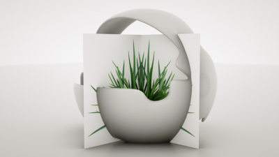

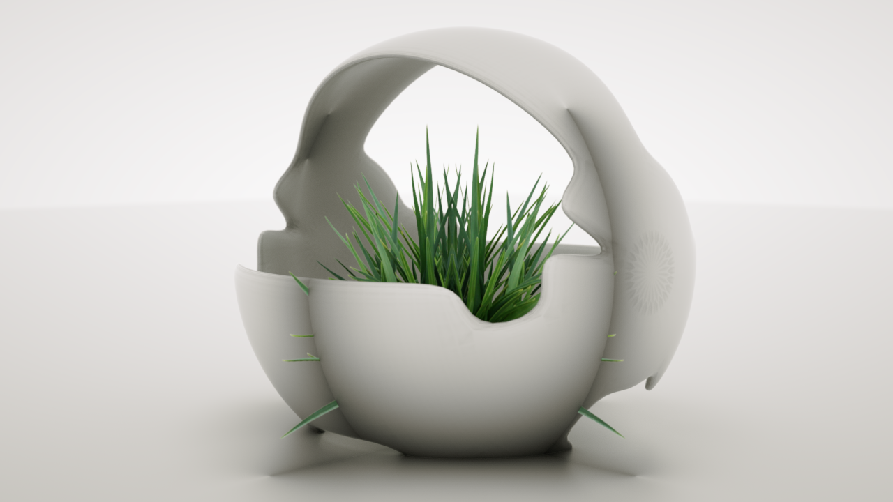

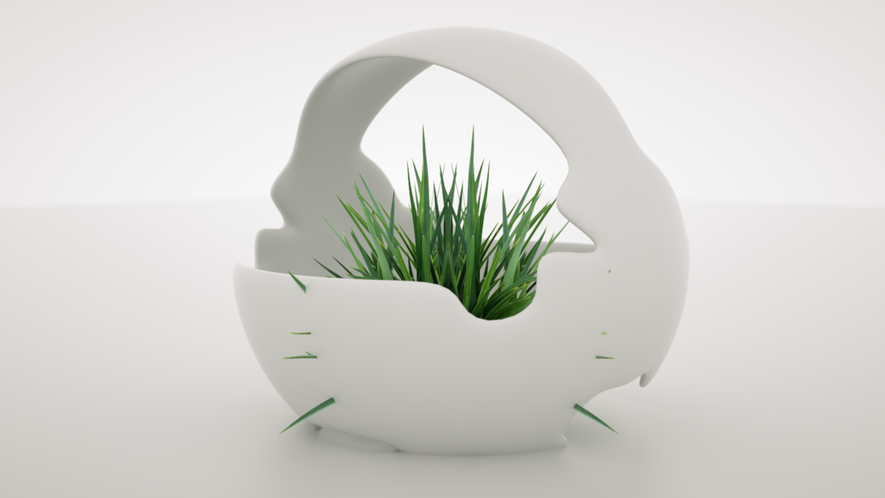

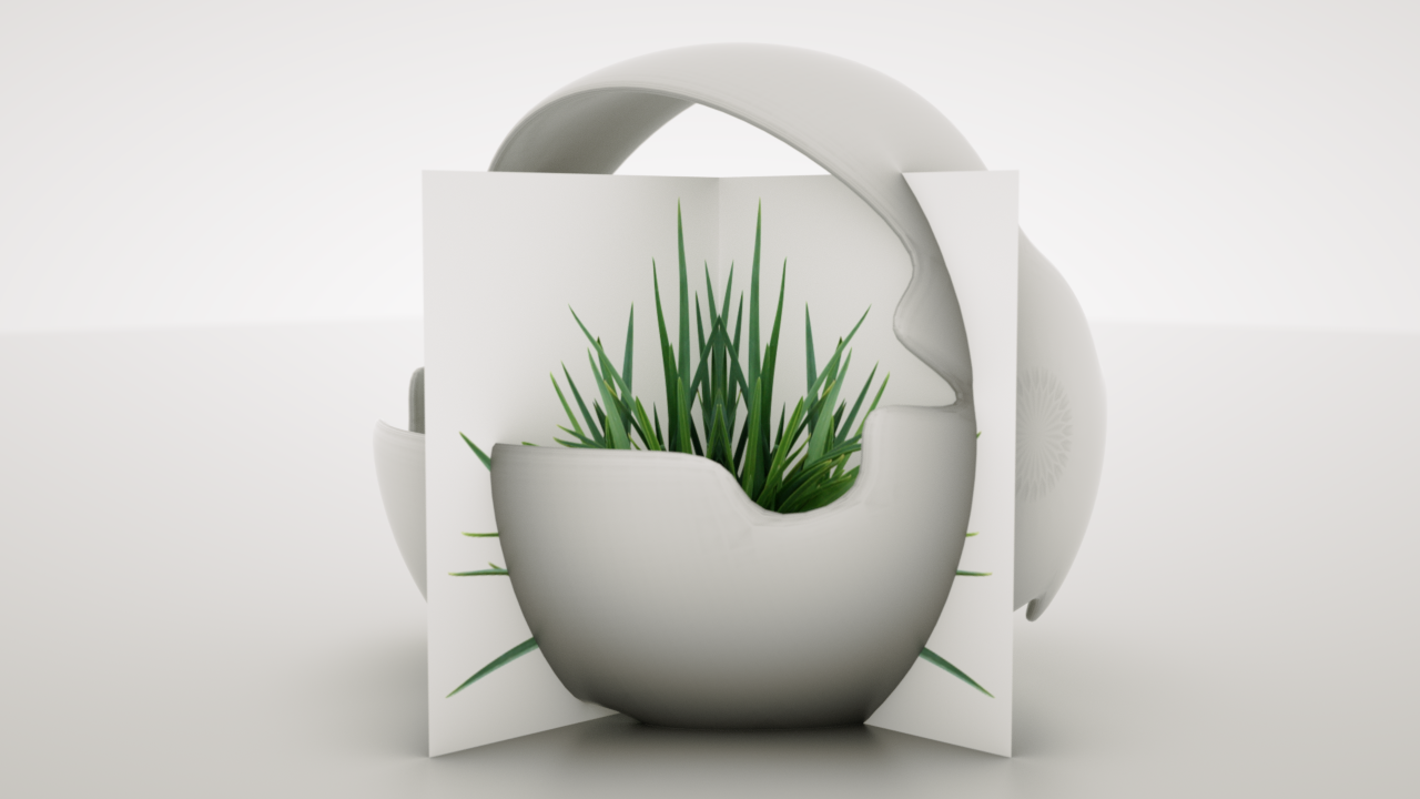

One thing I noticed though with the Dirt Texture and I'm not even sure if it's a bug, possibly just the inherent nature of the shader. Basically the Dirt Texture doesn't respect transparency values of an object with an opacity mask. Check my renders below: one with and one without the Dirt Texture applied.
No Dirt Texture
With Dirt Texture applied
Without transparency clipping
Notice the intersecting areas of the plant object with transparency clipping, showing the dirt texture on the ball object.
