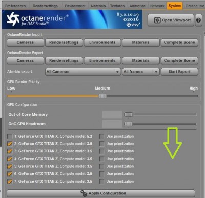

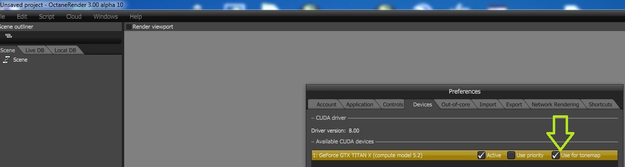

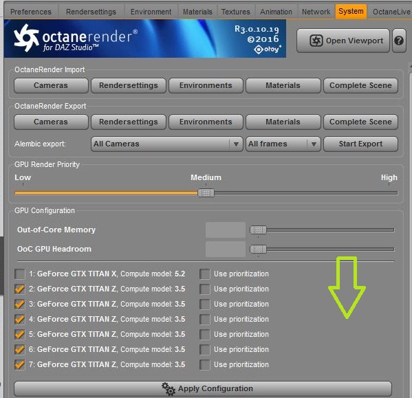

On the standalone, there is just a possibility to choose GPU tone-mapping. Do you think that you will integrate this feature in the plugin ?
I will add this to the next release.

Was looking to try out using the selectable Tonemapping feature that was introduced in standalone Aplha 10, but the OcDS plugin doesn't have yet. Will that be added soon?
Just FYI - The tonemapping processing (used in Post Processing and Baking Camera) was making the Nvidia & DirectX drivers clog up CPU when some PCIe 1x splitters were used, causing a PC freeze and crash. Marcus introduced the ability to disable tonemapping per GPU so those GPU cores on a splitter could still be used for the rendering, without being involved in the tonemapping processing, thus avoiding crashing the PC. Ie in my case I can assign the main GPU tone mapping while disabling tonemapping on all the other cards, so no more PC freezing crashing (on the standalone) :D
Thanks!
It should be in the next release.
