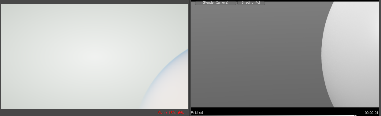

Paul I just did some quick tests and it seems there is a bug in the conversion of film width/height and offsets
1. Add sphere
2. Set film width = 10mm, height = 500mm, offset x = -8mm, offset y = -5mm, fit = FILL
The octane render is wrong. I have attached an image showing octane vs preview

This is fixed in the next release.Paul I just did some quick tests and it seems there is a bug in the conversion of film width/height and offsets
1. Add sphere

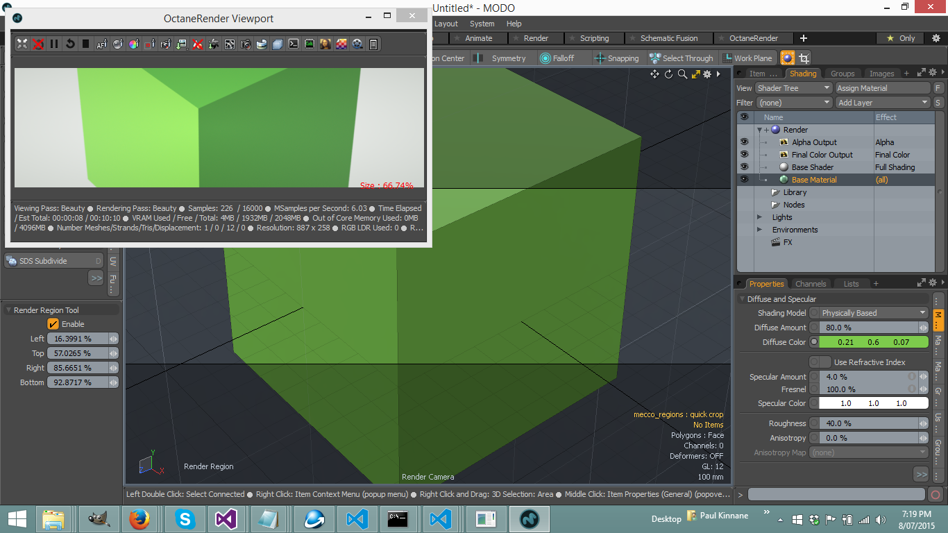

very nice update ! but sadly, 901 cropper still dont work correctly.
Can you give me more info to work with pls? What specifically is not working? Can you send me a sample scene where Cropper is not working?901 cropper still dont work correctly.
Have you tried deleting your Modo901.cfg?

yes I deleted my config! Wich version did you use?

Hi Tharso - I am using the plugin version 2.23.2.80.901 and Cropper version 801-15027. Attached is a screenshot showing it working and I have attached the scene too.yes I deleted my config! Wich version did you use?
