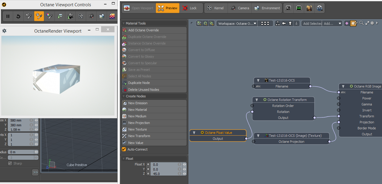

I have a UV map on an object that needs rotating 90. Seems Octane wont rotate the map.
In Modo UV Rotation input does not have any effect In Octane even after I add the Octane overide.
I added an Octane mesh UV projection but the numeric input does not do anything.

Add a Rotation Transform to the Transform on the Image (see screenshot below) then rotate with the Z axis.I have a UV map on an object that needs rotating 90. Seems Octane wont rotate the map.
