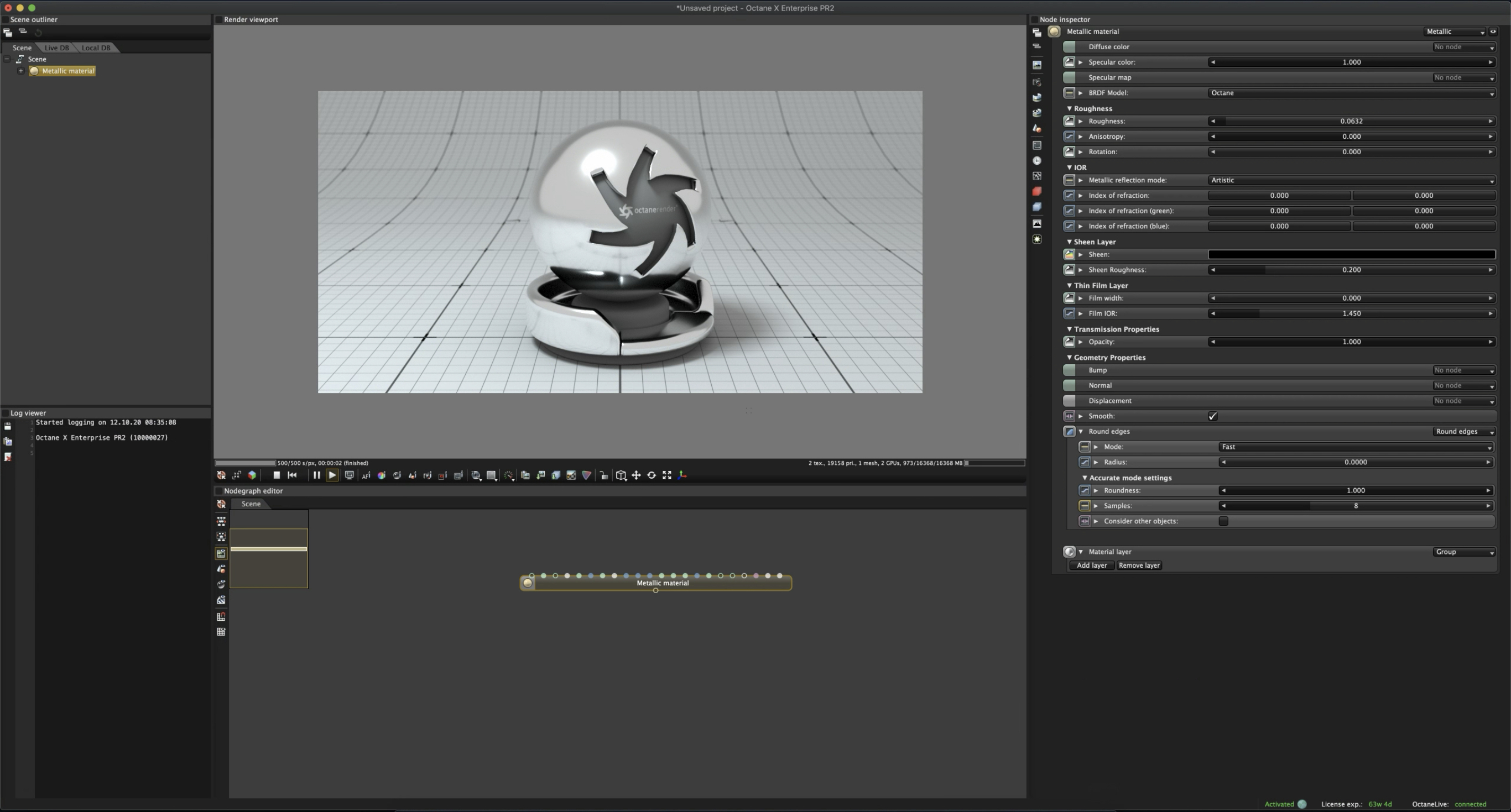

Hi guys,
currently only Standalone PR2 demo is available.
To check if your Mac is already supported in Catalina, please upgrade to 10.15.7, then download and install Standalone OctaneX PR2 demo:
https://render.otoy.com/downloads/a/113 ... _macos.dmg
Then open Standalone demo, right click anywhere in the node graph panel, and choose Materials/Metallic, to create the material node.
Now right click on the node and choose Render: If you have a similar result, you have a Vega or Navi GPU, and your Mac is already supported!
If not, and if you GPU is an AMD Polaris or Intel Skylake model, it will be supported by the upcoming Mac Os 11 Big Sur new Apple Metal driver, so you need to wait a little bit more.
OctaneX plugins demo versions are not available yet, but should be available with the next PR update.
At the moment, there are OctaneX plugins for C4D, Houdini, Maya, Poser, Unreal, Blender, Sketchup, Hydra Solaris, Lightwave, and Modo is on the go.
For new Otoy customers, if you cannot wait for the demo versions, and want to try also the plugins, you can buy a Studio subscription for € 19.99/month, and cancel it just after activation:
https://home.otoy.com/render/octane-ren ... ns/#studio
In this way it will not automatically renew at the end of the month, and you can try OctaneX for one month without restrictions.
Happy Mac GPU Rendering,
ciao Beppe
