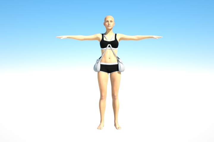

Thanks Paul. Eagerly waiting for it. Btw. one of the problems that I had reported before (viewtopic.php?f=44&t=55214&p=295786&hilit=+bag#p295786) seems to have been resolved. Now I am able to load the mirrored accessory properly :) . Not sure in which version it got fixed but I just saw the prop again and thought of giving it a try and it worked perfectly. Thanks for that. Probably it got resolved with some of the bug fix and code clean up you have done.
Issue fixed
Issue fixed
