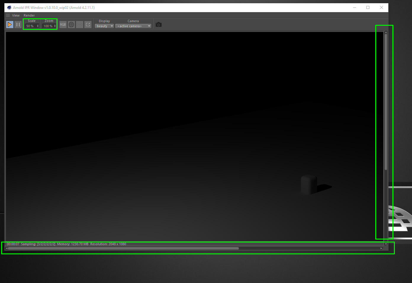

Hi there,
I know I have asked this before. I think there was some Kind of Limitation. I ask again though.
Would it be possible to add movement handles to the live viewer when a picture is locked while bigger then the screen.
If you look at arnolds live viewer its very flexible as you can scale aswell zoom in and out the frame (for example to identify noise)
I think that (if possible) would be a very welcome addition to the live viewer.
Cheers,
Raphael

Silverwing wrote:Hi there,
Cheers,
Raphael
You can make pan the image by LMB when you use locked mode. Only missing thing is a zoom.

Ha ha thanks. I did not even try it. Shame on me.
Is there a way to add handles? Right now nothing indicates that this is possible. Although I have to admit left mouse button is pretty self explanatory... if you try XD

Silverwing wrote:Ha ha thanks. I did not even try it. Shame on me.
C4D handles are not fitting to the current concept of LV. It can be done by some custom ways as i do for info graphics, etc..

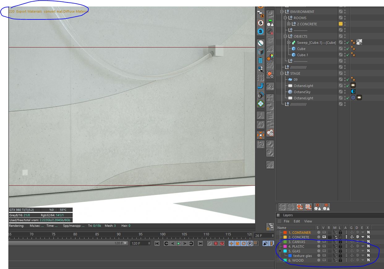

lasse_c
Posts: 4
Joined: Wed Apr 16, 2014 4:51 pm
Hey guys,
I happen to work with a lot of layers and materials which are assigned to different layers.
Just one layer is active at the moment, but Octane still exports every single material in the scene. I ticked on "Ignore unused Materials" but it's probably just for materials that aren't used on any object, right?
Is there a way to limit the export to only "active" materials?
Or am i missing something?
Bests,
Lasse
