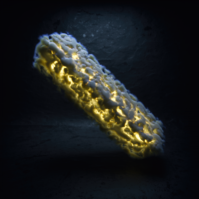

Fun time with the fog volume object and some emission :)
