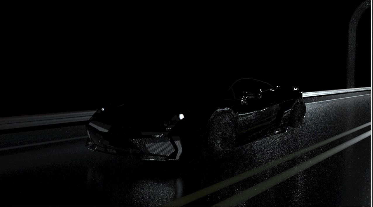

Ha, OK that makes sense. I'll start typing it in with a / from now on. Actually, I am getting weird motion blur which is why I was even thinking to type that. This is a poor frame but it shows that the rear left wheel of this car is ?missing? and the front left is getting some wild motion blur all over the place. I'm still getting used to these settings but really thought I had it all nailed down here.
Does 'Update Mesh' in the object tag need to be selected for something like wheels that are just spinning?

hard to see well but i suppose that understand your problem. It's common issue with mblur on rotated objects. If objects rotates very fast, you'll need to use some sub-steps. It can be adjusted in Render Settings. A parameter which is named as "Time sampling per frames". Try higher values
OK. I'm going to stop posting on here until I get used to the setting label differences between between Octane and Vray. Much of the wording in the manual and help links doesn't help much either. At least there are less settings though. Thanks for the reply.

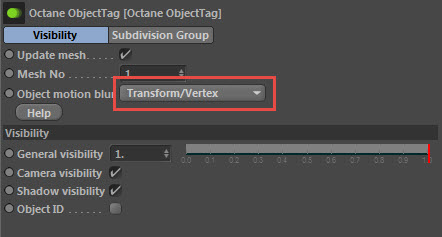

..here is the szene with the softbody-MB-failure. Maybe you could take a look.aoktar wrote:which paramters are you using on motion blur? Just drop me a scene which has issue with mblur
http://www.3dvisual.at/SBS-01b-mb-test.zip

Last, motion blur is maybe hardest feature which was implemented. Well, i'm going to check your scene. I'll post what i found.

It was easier than i estimated. Animated text is deforming, so this means we have to send vertex data to Renderer. If you change "object motion blur" to "Transform/vertex", it would work.Subroutine49690 wrote:Thanks for reply, I'm wondering what the reason could be.
