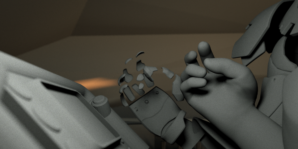

Here's what I found. For version 1.5, if you set your frame rate in DS4 to 1fps BEFORE you do any key framing, and export the alembic file with materials and camera...you have a good chance of it working as intended. When you import the .abc file into Octane Stand-alone, you'll also need to set the frame rate to 1fps. Of course your results may vary and the developers are choking on bug reports so don't bother asking Daz or Otoy for help. Here's a problem to consider. If your geometry is complex it may not bake properly and you end up with fragmented or displaced objects.

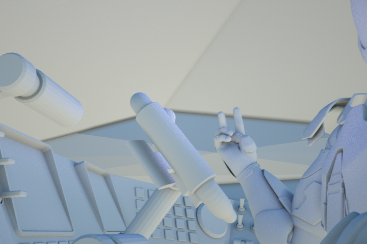

However, if you use the Daz Alembic Exporter. It bakes the geometry correctly.
Daz does not export camera information and only the material nodes. It will also crash OcSA if the frame rates do not match (so make sure they are set to 1fps). In some cases the geometry location will not match the camera location so you'll have to use a placement node to compensate. The OcDS plugin transfers camera location and focal information, but not the FOV, or DOF...basically only the information in the Octane render camera menu. This means getting really creative with the camera is not going to work. Keep it simple and you may get through the day without a tantrum (or purchasing Daz Alembic Exporter).
