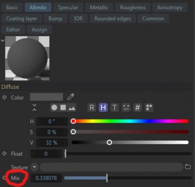

Using mix in Albedo channel cause huge 10-15 seconds ( depends of scene complexity ) lag, freeze of whole C4D while editing nodes. Other channels like specular, metallic works fine with mix. Tested in Universal and Standard Material
Image Adjust node, brightness adjustment - these sliders value ranges are totally out of way. Most of them should have values from -1 to 1. There is no way to adjust using sliders. I reported this many times...

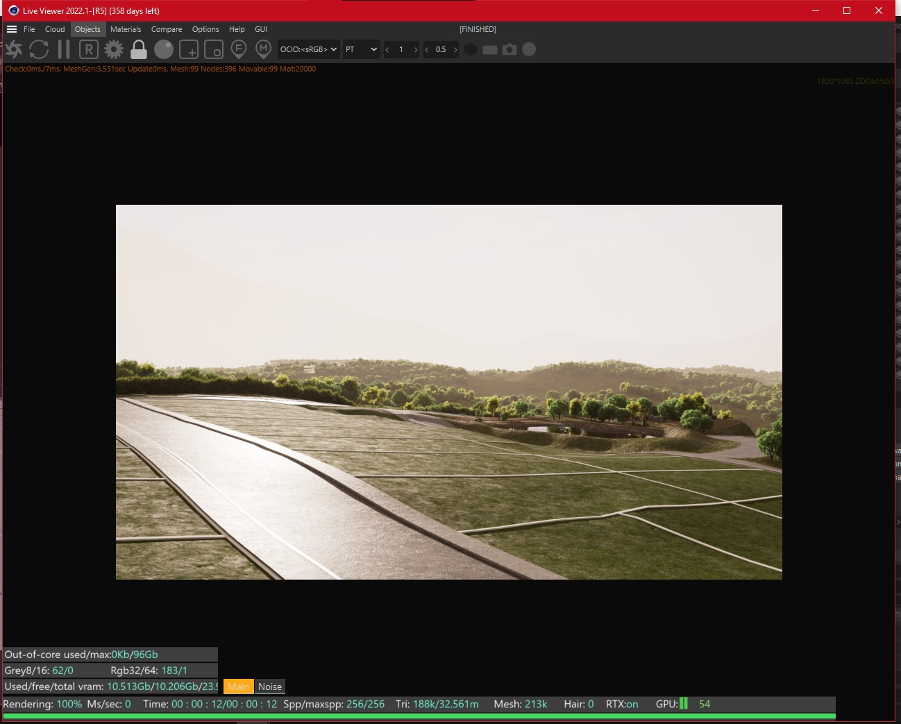

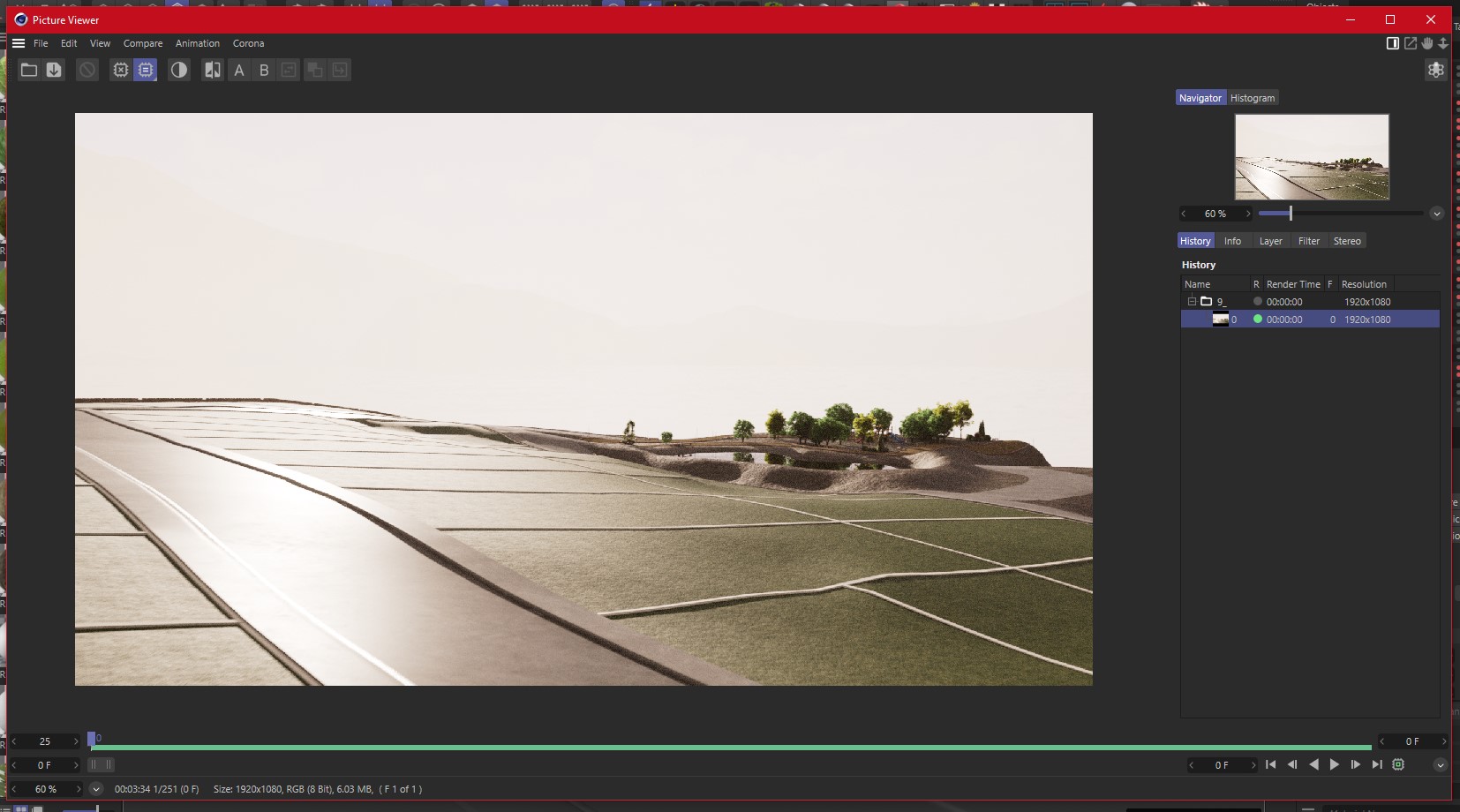

I don't understand: why after working with many takes with the model, I get this weird behavior, different model conditions when rendered on Live viewport window and Pictureview Render.
My .orbx files are not loaded on Production Rendering... they used to, a couple of hours ago... no idea what happened to get this different behavior.
What could cause this sudden behavior? From takes 1-8, .orbx are loaded on Production Render. Take 9 it won't... All setups are the same.
EDIT: so yeah... solved: had to delete the problematic takes and create new ones. No more problems.
.orbx files loaded correctly on liveview window
No .orbx files loaded on Production Rendering, some shaders are rendering different.

SSmolak wrote:Using mix in Albedo channel cause huge 10-15 seconds ( depends of scene complexity ) lag, freeze of whole C4D while editing nodes. Other channels like specular, metallic works fine with mix. Tested in Universal and Standard Material
Most likely you have something specific to you that's giving lag. Be sure "Faster viewport textures" are ON and alternatively use low viewport texture resolutions for the material. Even make your material from scratch or delete some textures until find the problem.
