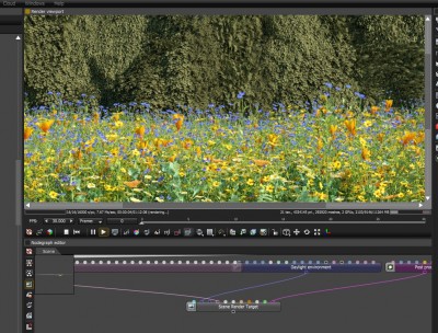

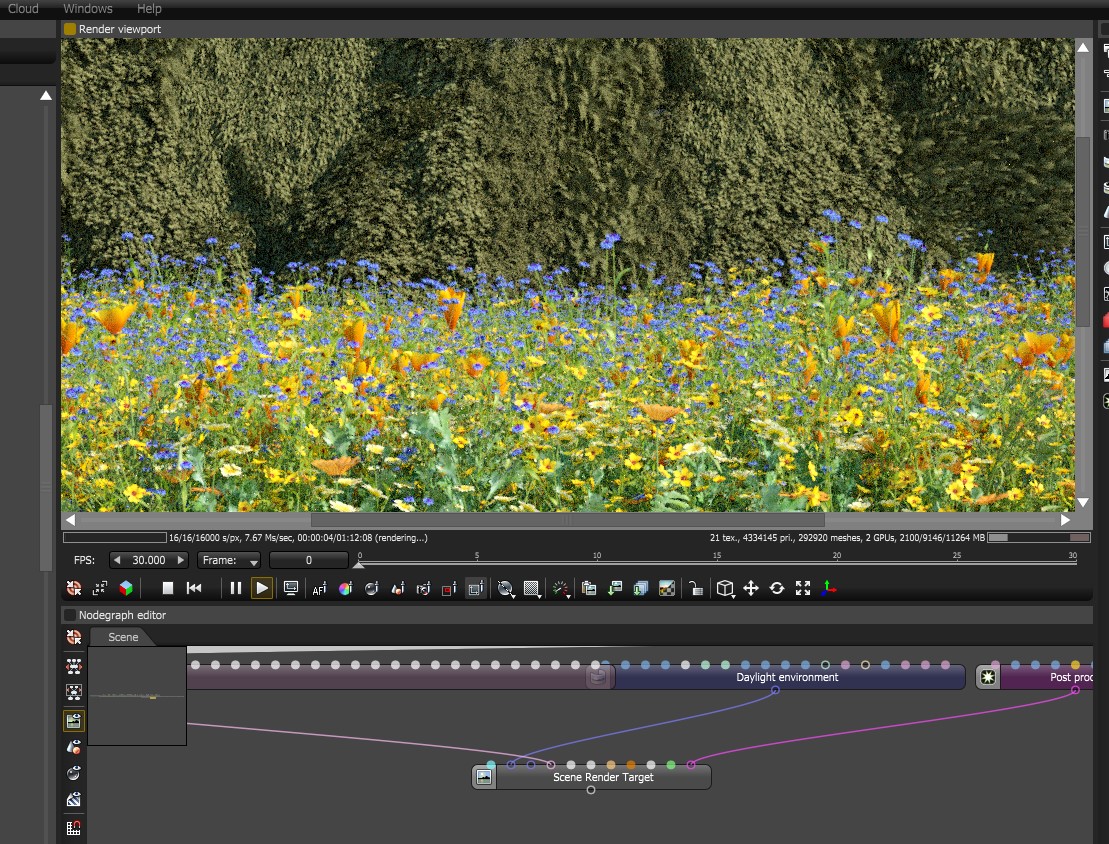

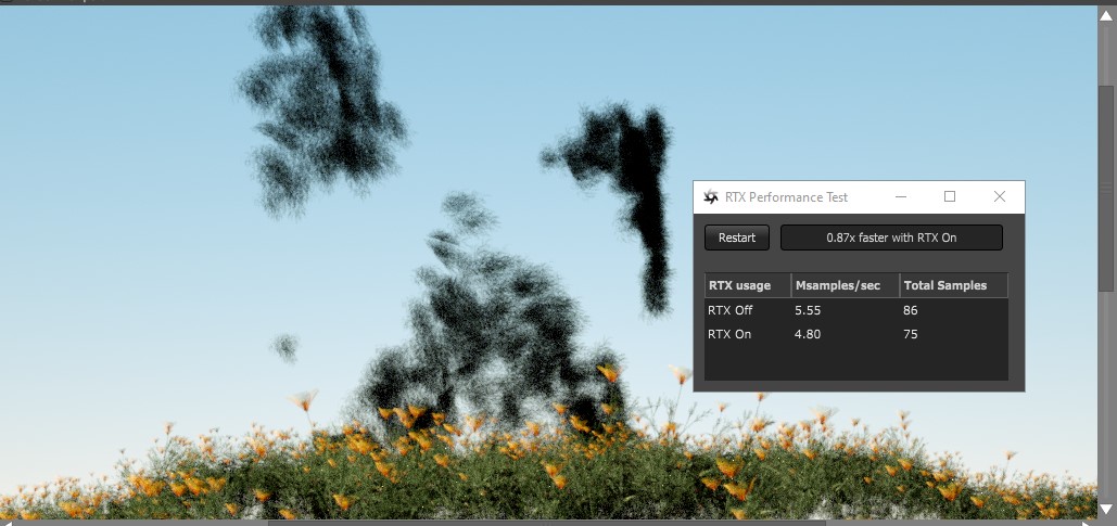

Very strange result on this scene.
2*2080Ti (NVLink)
Scene - > http://bit.ly/34CjKPn

I have a RTX 2080 super and the Rtx acceleration is useless (same render time OFF/ON)

andrey.krivulya wrote:Very strange result on this scene.
2*2080Ti (NVLink)
Странный? Я бы сказал типичный)
