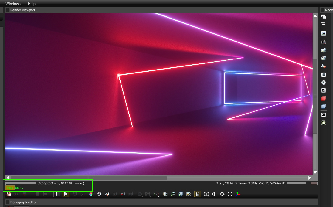

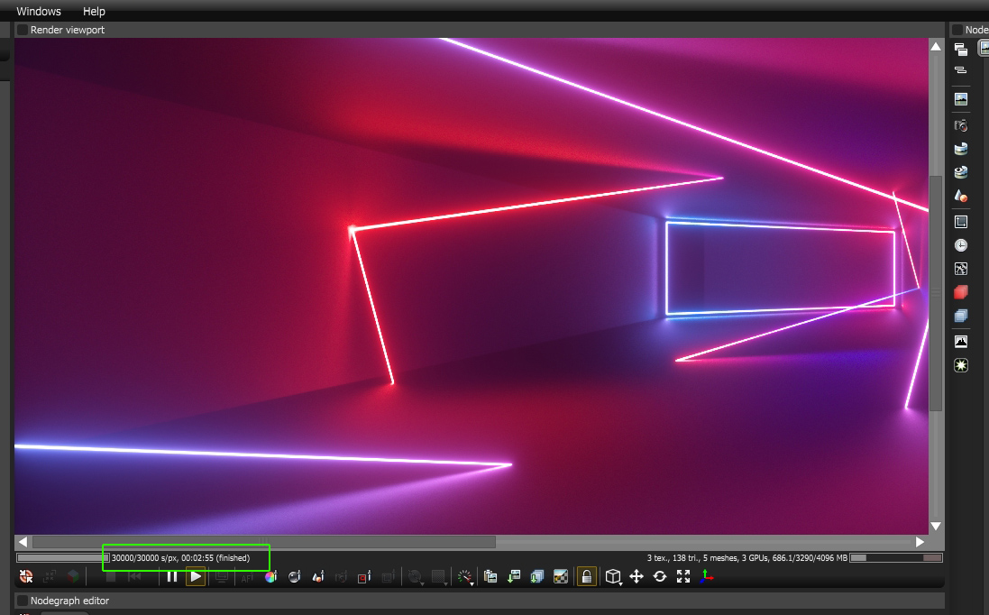

Simple scene exported from 3ds Max
1) Render without Denoiser - 2:55
2) Render wiith denoiser - 7:08 WHAT?
Also, I don't see any help from AI Light. ON or OFF - same speed and result.

ramone163 wrote:Simple scene exported from 3ds Max
Samples: 30000
Adaptive samples: ON
@Ramone163
1-try setting the sample amount to say, 200 s/px (vs the 30,000), and then
2-Set the active render pass as the one that says "DeM", I see you have it on "Main". You mouse click the little box that says "DeM" in your green highlighted photo.
3-Check the "Denoise on Completion" box in the Imager tab area settings, this will denoise in the DeM render pass only at the end when it reaches your sample target, say 200 s/px
Then you play with it to see if you could get a better looking render faster than 2:55. I am finding some scenes it works (Denoiser beats straight render), but most often denoiser 'net' takes longer.
For simple animations almost always straight render is faster. Denoiser adds no value at the current processing speed in total. Your comparison shows how the denoise calculation slows down the renderer.
PS - I have no idea myself what the AI Light thing is and how it works!

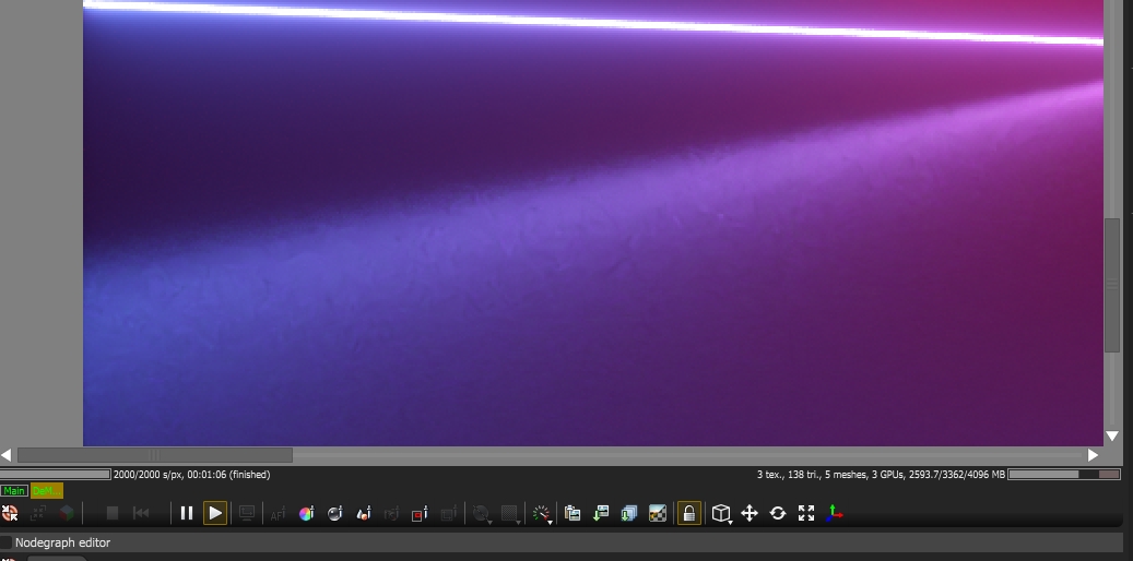

For my scene Denoiser is useless.
(Neat Video Denoiser makes better result with my scene)
2000 samples and I get this result with denoiser:

ramone163 wrote:For my scene Denoiser is useless.
You had that render at 1:06 for 2,000 s/px. But your 30,000 s/px with no denoise was clocked at 2:55.
So the true test now would be then to render with denoise to ~5,900 s/px, or whatever sample amount, with denoise on, clocks close to 2:55.
Then, you can see which looks better (1) Denoise with, say, ~5900 s/px @2:55, or (2) No Denoise with 30,000 samples @2:55.
(But I know what you are saying, that you would like to have it render much faster with better results with the denoiser...)
