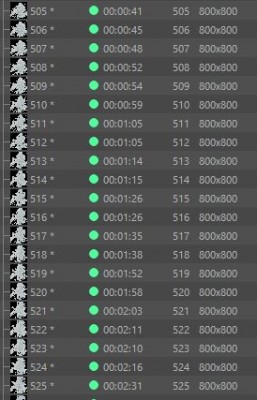

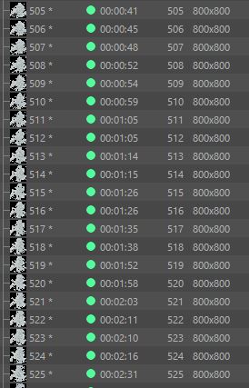

Hello,
something strange is occurring while rendering an x-particles simulation.
it's a simulation driven by the XpSound modifier and in which the number of particles is pretty much constant for the entire duration.
Before rendering I cached the entire xp system. Despite this, I see an incremental render time for each frame. The first frame renders in a little over 20 seconds while frame 500 is up to 6m30s
Anyone noticed this behavior? Thanks in advance.
EDIT: stopping and re-starting the rendering results in fast rendering at first and then slows down again over a few frames. see attachment.

motion blur?alessiodevecchi wrote:Hello,

motion blur was actually on. i switched it off now. let's see!aoktar wrote:motion blur?alessiodevecchi wrote:Hello,

hey ahmet! that is it. without motion blur the render time / frame is constant. thanks.aoktar wrote:motion blur?alessiodevecchi wrote:Hello,
...but why is that anyways?
