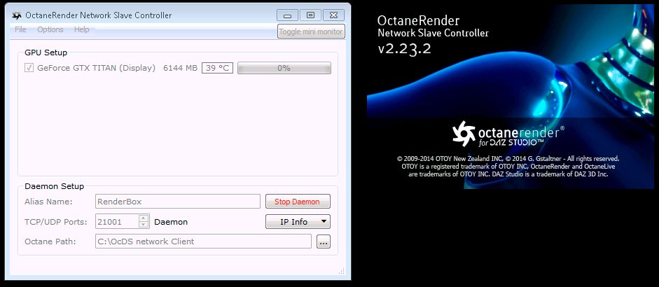

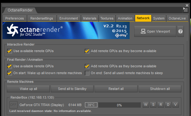

Anyone using network rendering feature with the latest Beta?
My master and slave nodes can see each other, I can restart and suspend the slave using the buttons in the DAZ Plugin network tab, I can see the temperature of the slave's GPU... Yet I'm not able to make the slave to actually help rendering...
Installed both the plugin and the network slave from the plugin installation package. Both systems are running same driver version for the GPUs.
Firewalls on both machines are disabled.
Any ideas?

Slave PC
Slave PC
Plugin Window
Plugin Window

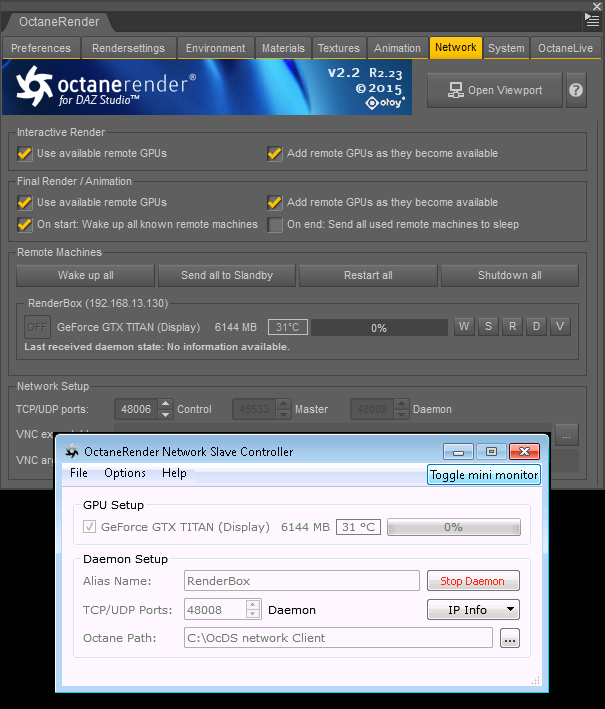

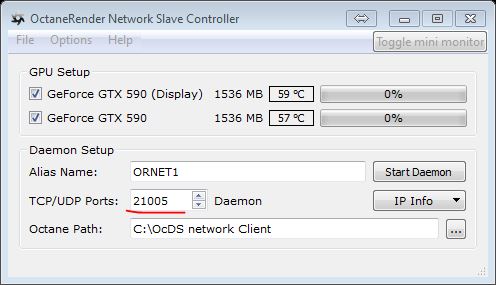

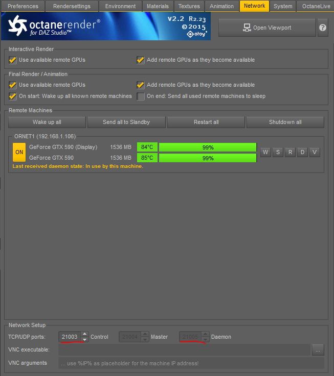

hi birdovous,
just a couple of ideas:
1. what happen if you change the TCP/UDP port and correct the demon parameter on the slave accordingly?
2. could you turn the slave to be the master and vice versa?
3. what about the firewall?
ciao beppe
