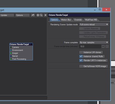

If you are using morphs over cloned objects, be sure to disable the "Instance LW clones" options in the render target root node editor. By default the plugin adds the LW clones as Octane instances to save memory, but this instances can't have independent deformations.kostache wrote:I have a problem with morphs. Octane refuse to render morphed states of object - always it looks like original shape. Why?
-Juanjo
