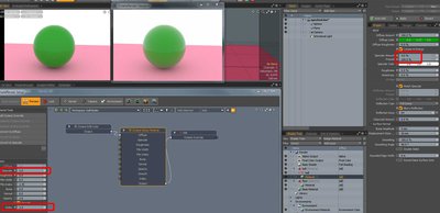

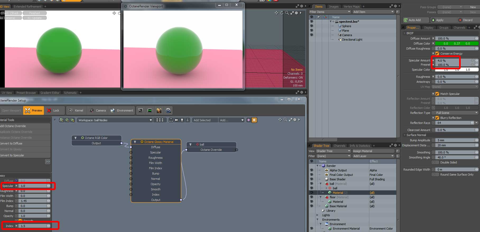

OK I did a quick test with the new version, but you are still setting glossy specular = modo specular amount. This gives the wrong result. Glossy specular needs to be 1
I'll try and post some pics and a scene to clarify things
UPDATE: The attached image shows you which values the override should be using to match modo. I have also attached the scene

OK I attached an image and a scene to make myself clearer.
Right now the "on the fly" conversion is not setting specular to 1.
That helps. You can redownload and install 1.50.0.51 to see the change. The main issue now is if the Modo material is highly reflective, and also has a high diffuse value - but all other combo's seem to work well.
