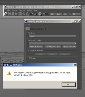

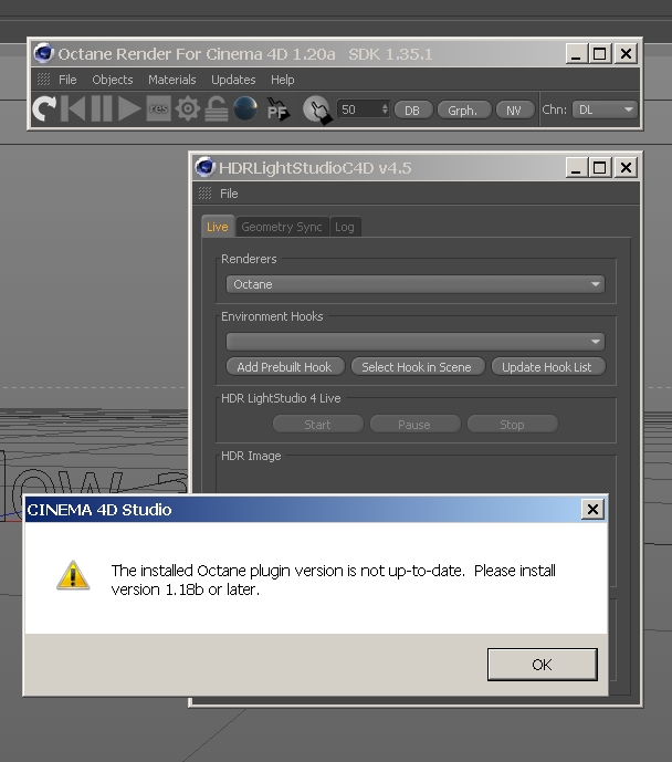

hello,
unfortunately the latest version does not work with the hdrlightstudio-live-plugin together.

For me HDRLightStudio plugin works fine with 1.20a. Absolutely no problem.
Maybe you should completly remove the folder "c4doctane" and reinstall the Octane plugin from a fresh zip file?

About HDR Live studio. I was one of the betatesters. I downloaded the official release they published today and tryed it in 1.18, 1.20 and also in the latest 1.21a ahmet posted on the site before. Worked in every version after 1.18 like a charm.
Maybe you should try to only have hdrls and c4doctane plugins in your plugin folder and retry - maybe its a plugin related problem! Also make sure you have the latest 4.3 release of HDRLS installed!
If not, one of you guys where its not working, should post a simple sample szene, so i can try here if its working!
