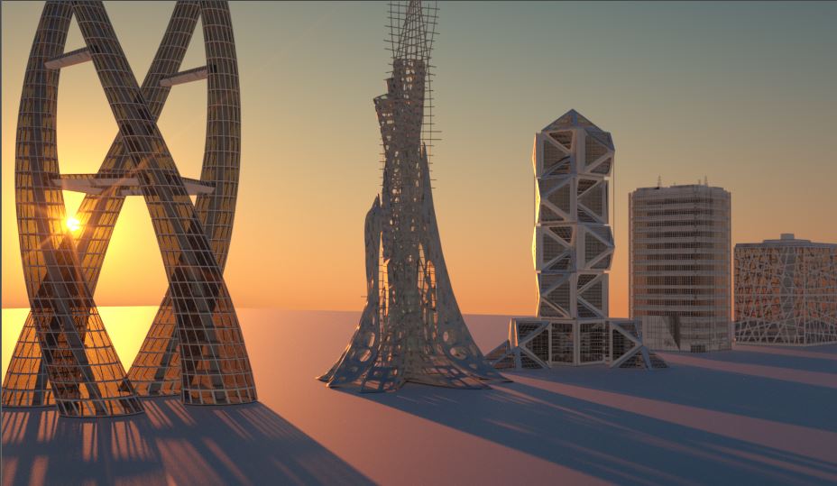

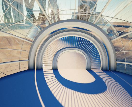

Aoktar,I have been trying to get the glass material in the new library to allow light to pass through. But so far I have tried several of them with no success. Any suggestions? (the arched area has no glass)
Asrock z77 extreme9 | Intel i7 3770K 3.5 | Win 7 64 bit | (1) EVGA Titan| 30" Apple Cinema Display | LEPA G1600W PSU | 16GB Ram | Storm Trooper Case |
Autodesk Inventor>3DS Max >Cinema 4D R14 Broadcast
i have'nt checked, but did you enabled alpha shadows?buzby wrote:Aoktar,I have been trying to get the glass material in the new library to allow light to pass through. But so far I have tried several of them with no success. Any suggestions? (the arched area has no glass)
Hi Buzby,
Just some more info... For this you will need to do one of two things:
1) Use PT or PMC and set caustic blur to 0.02 or so.
2) Use direct lighting and enable "fake shadows" on the glass material.
(and for both as Ahmet says enable alpha shadows)
Chris.
Chris.
Doh! I was using 0.30 of the plugin. I dont know how I missed 0.42 release. I will try your suggestions.FooZe wrote:Hi Buzby,
Chris.

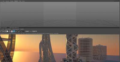

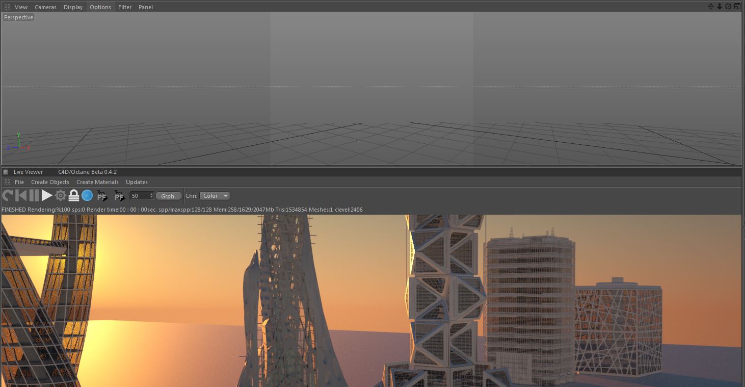

This is probably more of a C4d question, from the king of the noobs, but why in the world does c4d not show this scene in its preview window? I have to keep scrolling middle mouse button until I am practically in the middle of a building to view anything, but I can see it fine in OR
it seems a problem related c4d. Maybe viewport clipping or shading settingsbuzby wrote:Doh! I was using 0.30 of the plugin. I dont know how I missed 0.42 release. I will try your suggestions.FooZe wrote:Hi Buzby,
