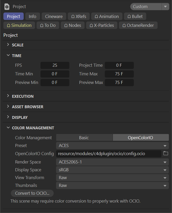

Change the settings in Edit > Project Settings > Project tab > Color Management to the following:
  • Select the OpenColorIO button
  • Set the Preset dropdown menu to ACES
  • Choose the location of the installed config.ocio file — This should be the same file as used for Octane
  • Set Render Space to ACES2065-1 — This will conform Cinema to Octane standards. You can choose ACEScg, but you will then be limiting your color space to a subset of the full range offered in the ACES2065-1 option.
  • Display Space — There is only one option, sRGB, which is correct
  • Set the View Transform to Raw — This will allow Cinema to show you the Octane results without additional processing.
  • Set the Thumbnails to Raw — This will allow the Thumbnails to be correct, without additional processing by Cinema 4D
Change the Picture Viewer View Transform setting to Embedded/Raw or Embedded.
Set the Colorspace Menu in Live Viewer to ACES2065-1. Picture Viewer and Live Viewer will match with these settings in Cinema 4D R2023. You can also choose A different colorspace in Live Viewer, such as OCIO<> (and choose the output transform from the list) and it should match as well.
I am still working out the settings you need, so I may have missed something. If so, I will update this post.

There are not any integration for C4D's OCIO options. Please follow what Jayroth says

As for settings - I have already set them as in your setup except color space in Live Viewer set to HDR/sRGB ( I'm using ACES switch in Octane Camera). When I set it to ACES the view is linearized , dark.

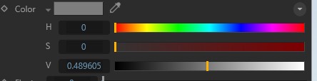

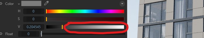

Octane native color GUI type in C4D OCIO mode has not linearized color slider - most of the slider space is occupied by bright colors :
The same slider and color in C4D Basic color mode :
