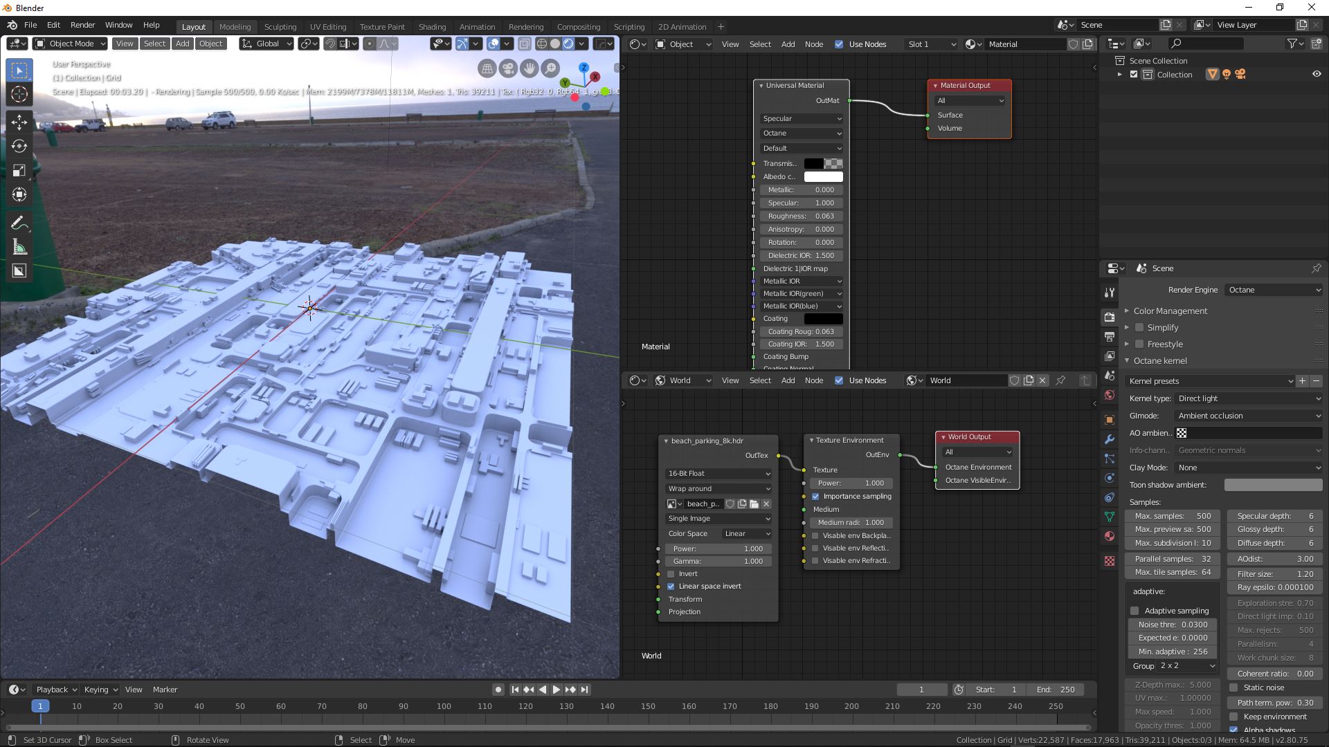

Marquis wrote:I've been trying to use AO texture for ambient occlusion but it seems it doesn't work at all?
any hits how to set it up correctly
or maybe it isn't implemented yet?
It's a texture used for AO look:
AO Ambient Texture - Specifies an Ambient Occlusion texture, which is used for the AO calculation instead of the environment. If AO Ambient Texture is disabled, the environment is used instead. This gets rid of the blue tint on white walls caused by the blue sky (like Octane Day Light).
CPU – i9 13900KF, 128GB RAM, GPU – RTX 4090
System – Windows 11
My Behance portfolio, Blender plugin FB support group
Marquis
Posts: 6
Joined: Fri Aug 16, 2019 6:05 pm
I know what it is, I wonder why I couldn't get it to work
it seems broken for me but maybe I am doing something wrong?
J.C
Posts: 1881
Joined: Thu May 13, 2010 6:35 pm
Location: Wrocław
Marquis wrote: ...
You are not doing it wrong. The feature is broken in Blender since it was introduced there. Looks like nobody cares as nobody has ever tried to use or test it.
System – Windows 11
linograndiotoy
Posts: 1544
You can get the exact same result using a Texture Environment. The AO Ambient Texture option is a potential different way to do it, but it doesn't make much sense since the Texture Environment option gives more possibilities (like being able to orient the texture or change the intensity as needed, for example).

Marquis
Posts: 6
@linograndiotoy
nah, not really, actually not even close
it's not env texture, it is different tex which is used for ambient occlusion to help get rid of excessive color tinting in the shadows
read what J.C. wrote, there is quote from manual
Marquis
Posts: 6
@linograndiotoy
OK, here is image with expected behaviour, this is how it would work if it would work
