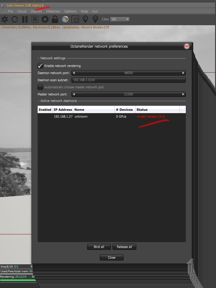

here is what I get
the machine I am trying to enable in network rendering has Stand alone 3.00_alpha_1.
and the latest Cuda 7.5. same for me.
Witch Standalone version works for you ?
thanks.

eightvfx wrote:Thanks for your reply.
here is what I get
thanks.
needs to be alpha 6 as well for the stand alone

Oh great!
thanks.
I don't look all the time at the standalone and the c4d pluggin page in same time.
I missed that from last c4d pluggin release.
Thanks again for taking the time to answer.
