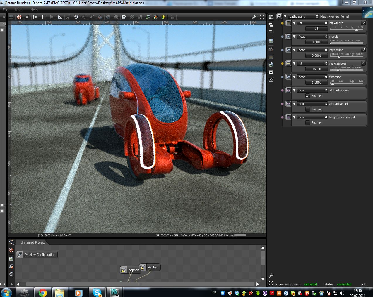

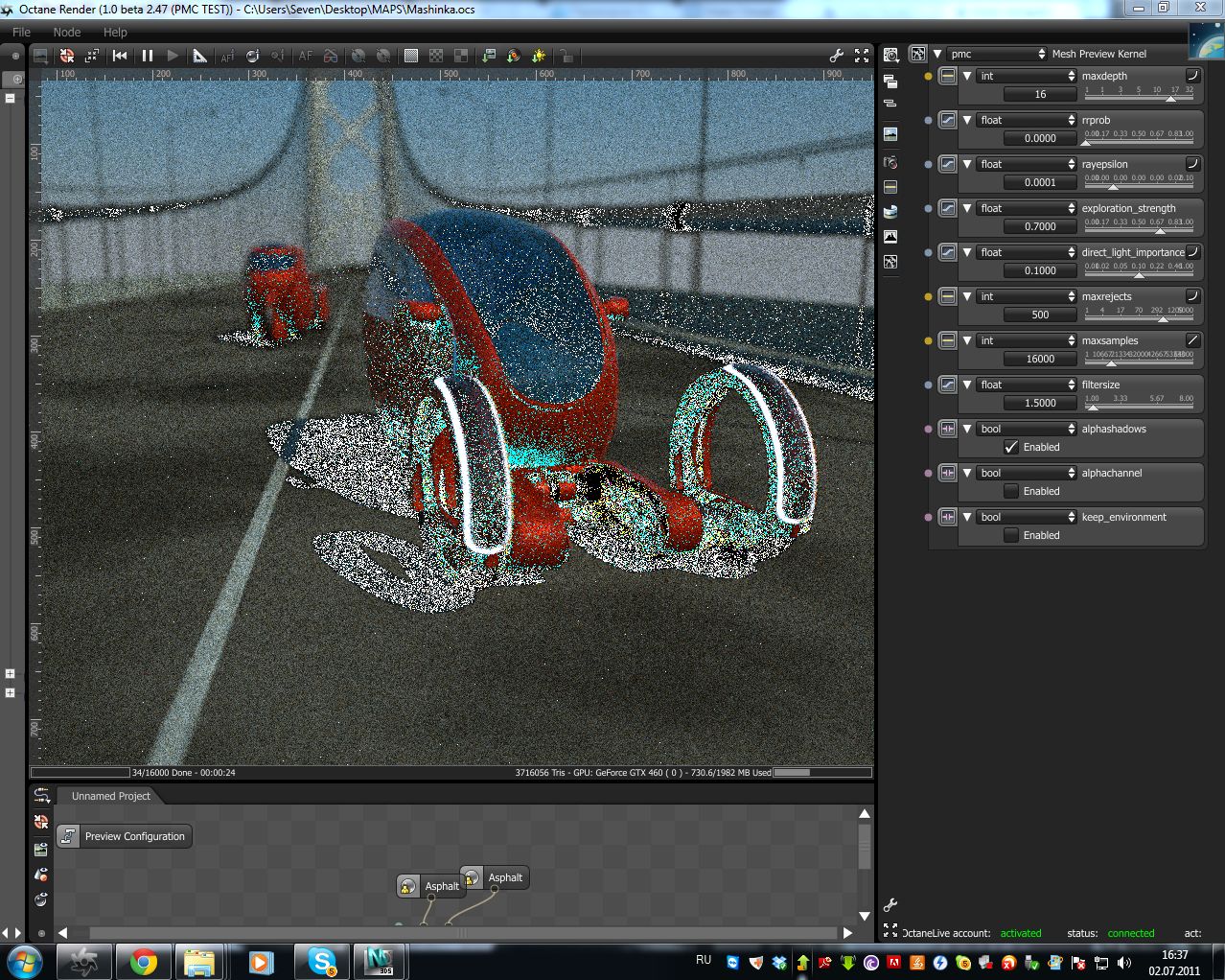

bugs PMC

Could you please send that scene or a similar one that exhibits the same problem to support (at) refractivesoftware (dot) com ? We definitely would like to fix that issue.Elvissuperstar007 wrote:bugs PMC
Thanks for your help,
Marcus

ok! )abstrax wrote:Could you please send that scene or a similar one that exhibits the same problem to support (at) refractivesoftware (dot) com ? We definitely would like to fix that issue.Elvissuperstar007 wrote:bugs PMC
Marcus
