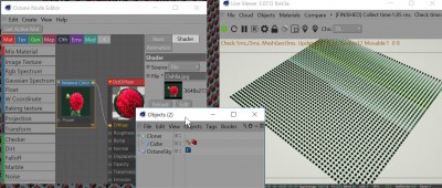

Hi Dear...
I know it is a test version now.
I have tested "Instance Color with image" and have not been successful.
Standalone options are different.
Is it still under development?
I could make it with Shader Effector.
Thank you.

eyeonestudio wrote:Hi Dear...
Thank you.
The attachment instance color_cr.png is no longer available

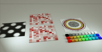

It's fully ready to do this with several ways. InstanceColor on image mode that's getting colors from per pixels by matching clone ids.
Here is a sample scene with cloners+scatter+instance ids from object tag.
instance-ids.rar
(477.98 KiB) Downloaded 327 times
