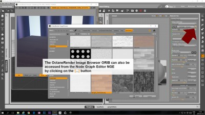

I experimented with the OctaneRender Image browser ORIB and loading images in the past weeks and was not able to produce a crash from the ORIB.
Retested again with
OctaneRender for DAZ Studio 3.0.6.16
Daz Studio Pro BETA - version 4.9.1.30 - Products installed with DAZ Connect
with .jpg, .hdr, .png, .dds, .tif, from a few kb to 50+MB file sizes.
Does the ORIB also crash for you when you access it from the Node Graph Editor NGE and change any other file type than .hdr?

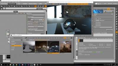

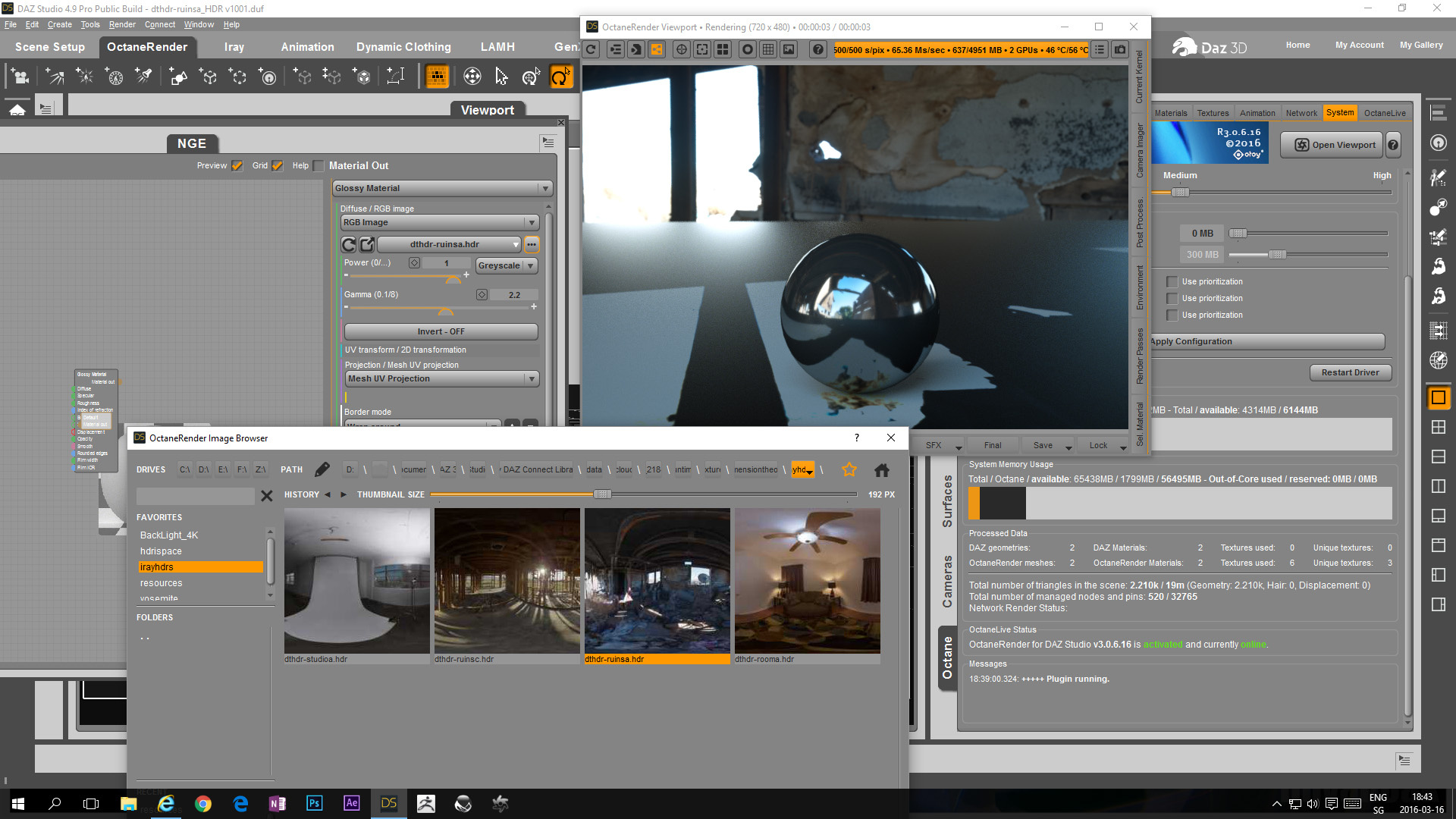

Update / Edit:
Last time I was searching around for hours when I could have checked for an error message.
Maybe worth a try:
Try to have both the NGE and the ORIB open in a floating not docked state.
Rearrange them so you can still see the Octane "System" tab where error messages would appear.
Can you spot an error message in the system tab right before the ORIB crashes?
Can you spot any error message in the log file after a crash?
