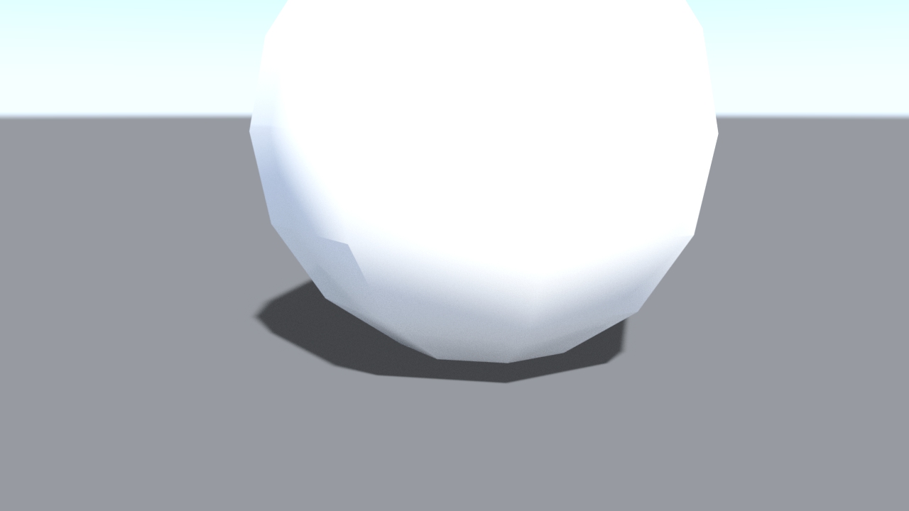

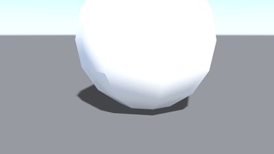

Hydra wrote: For instance, in the provided example we are looking at a close up of a nude arm pit while the arm is straight out. Most arms aren't naturally in that position for a close up. Most arms are down in some way, and often clothing is worn.
I've just used the same mesh and close enough lighting and pose to show that effect is not Octane-specific and it's not a bug. It actually can be seen on almost any low-poly mesh, even sphere:

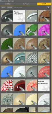

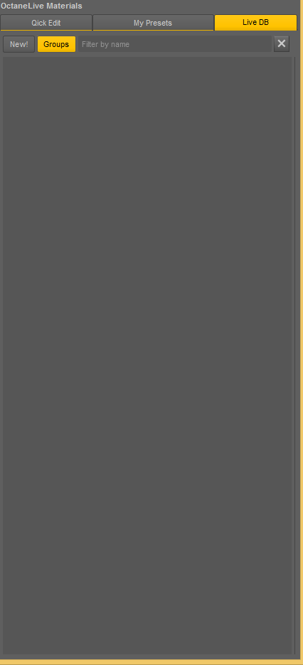

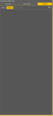

Yes, I've been having random issues with the LiveDB sometimes not loading properly. For example, in the below images the LiveDB has loaded some ungrouped material files (first pic) but if you click on a group (second pic is Wood group) then it doesn't have any materials loaded.

If I close DAZ and restart it sometimes the LiveDB will work again.
