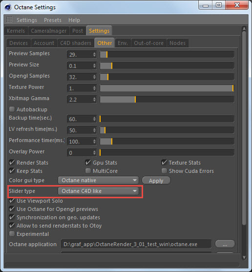

dinf wrote: But I found an issue I had before: "shifted" sliders. Don't know how to explain, specific values are not at the positions I would expect them. I don't think this is the way it should be?
Dont't use "Cinema4D" in this setting.

For RotX/Y it is working, for Color Sliders not. Pos. 0.214041 is still 50% grey.
I could switch to C4D native, in this case I have C4D style only, but I don't know wich one is the real value - 0.214041 or 50%?
Nevertheles I use both, color wheel and sliders.

believe your eyes. Octane values are linear. Plugin makes value conversation for srgb to linear. color in octane swatch it corrected for your view. This is same since two years

Yes,I remember that I already asked for it, time ago ;)
OK I'll get close now, thanks for help!
