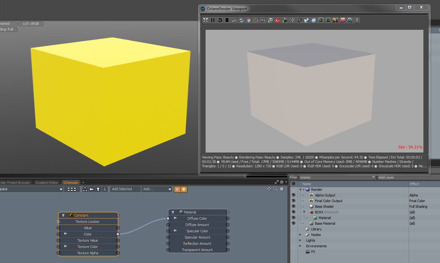

Any chance to get nodal shading working in 901, or do we have to pray on the altar of TF? :)
The box is white even after refresh, it simply ignores the constant node...
I've also posted here: http://render.otoy.com/forum/viewtopic.php?f=34&t=47934
[EDIT]: It does work!!! However the constant needs to be setup like this. It kind of defeats the purpose of having nodes at all, though... Hopefully this workaround can also be applied to more complicated stuff.
see below for image, since I don't know how to insert a second one here (no wonder the shading didn't work lol)

studio3lhd wrote: see below for image, since I don't know how to insert a second one here (no wonder the shading didn't work lol)

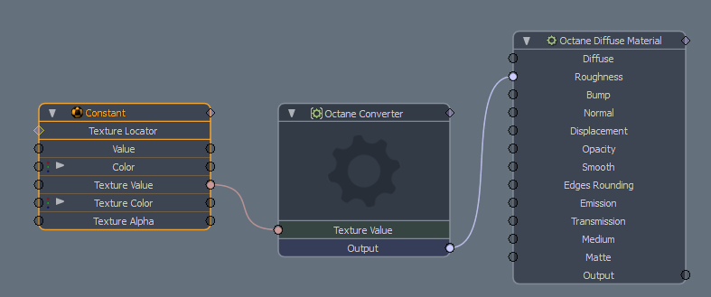

Feature request: Modo value to octane value converter node
I was wondering if you could implement a "conversion" node that would let me plug a modo node into it, and it would convert it to a value that could be plugged into an octane node.
The converter could have an option where you select what type it should convert to: eg rgb color, greyscale color, int, float, bool, enum etc
This would let me do stuff I cant normally do eg. I could use an expression node or some math nodes to change a value then input into octane
I've posted a screenshot of what I mean (the "assembly" is just for illustration... it would be your converter node)

I believe you need to re-order the instructions a bit - [[[2) Add a Cube, assign the “cube 1″ material to it, add an Octane Override to “cube 2″]]] - but we have yet to make "cube2" in step 3..) :)
However, I wasn't able to reproduce this behavior, I assume you also drag&dropped the checker with it, since they appear in both materials?
