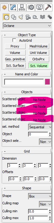

Octane scatter doesn't work.
I'm using max14.
Where you could previously add an object to be the surface or an object to scatter, it now just says 'node' and nothing happens.
Can't even see an option for adding an object to be the bounding volume for the volume scatter.
Loaded an old scene and it renders the scatter but the slots for selecting just say 'node'

Rik wrote:Octane scatter doesn't work.
I'm using max14.
The attachment Screenshot 2023-11-08 110841.jpg is no longer available
Hi Rik,
I can't test with max 2014 at this time .. it might be a UI issue..

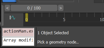

When you click once on a node button, the bottom line information should change from "Click and drag to select and move objects", to "Pick a geometry node"
Do you see something like that ?:
Also, could you try to open the maxScript 'Scripting Listener', select the ScatterVolume object, and type
$.input1 = Box()
This should create a box, and assign it to the first node..
try to de-select and re-select the ScatterVolume object, and see if there's a Box001 on the first node ?
If not, try rendering anyway, to see if there's a box .. ?
Also, could you try to turn on/off Preference / User interface / Expand Object Dialogs width [Experimental] ?
It may change the way those buttons behave ...

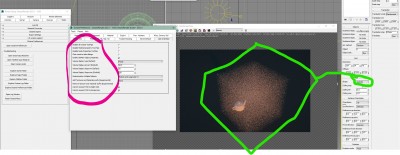

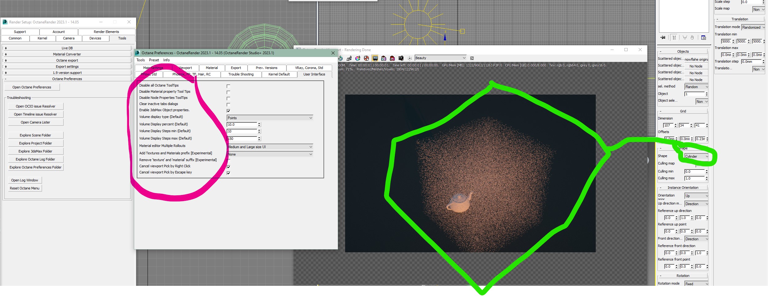

Rik
Posts: 423
Joined: Wed Jul 28, 2010 8:57 pm
Thanks Neon.
That works. Was looking for a way to select the envelope object to 'hold' the scattered objects (like with the scatter surface...) Hadn't realised it was done like this. Is there a tutorial anywhere, like the C4D ones on you tube? Couldn't even find anything in the manual.
For the shape of the envlope, selecting anything other than a box makes no difference to the shape. Thought selecting cylinder would make a cylindrical envelope but it does nothing.
Have I missed something?
Also, can't see an option for 'Expand Object Dialogs width [Experimental] '
Am I looking in the right place?
Cheers

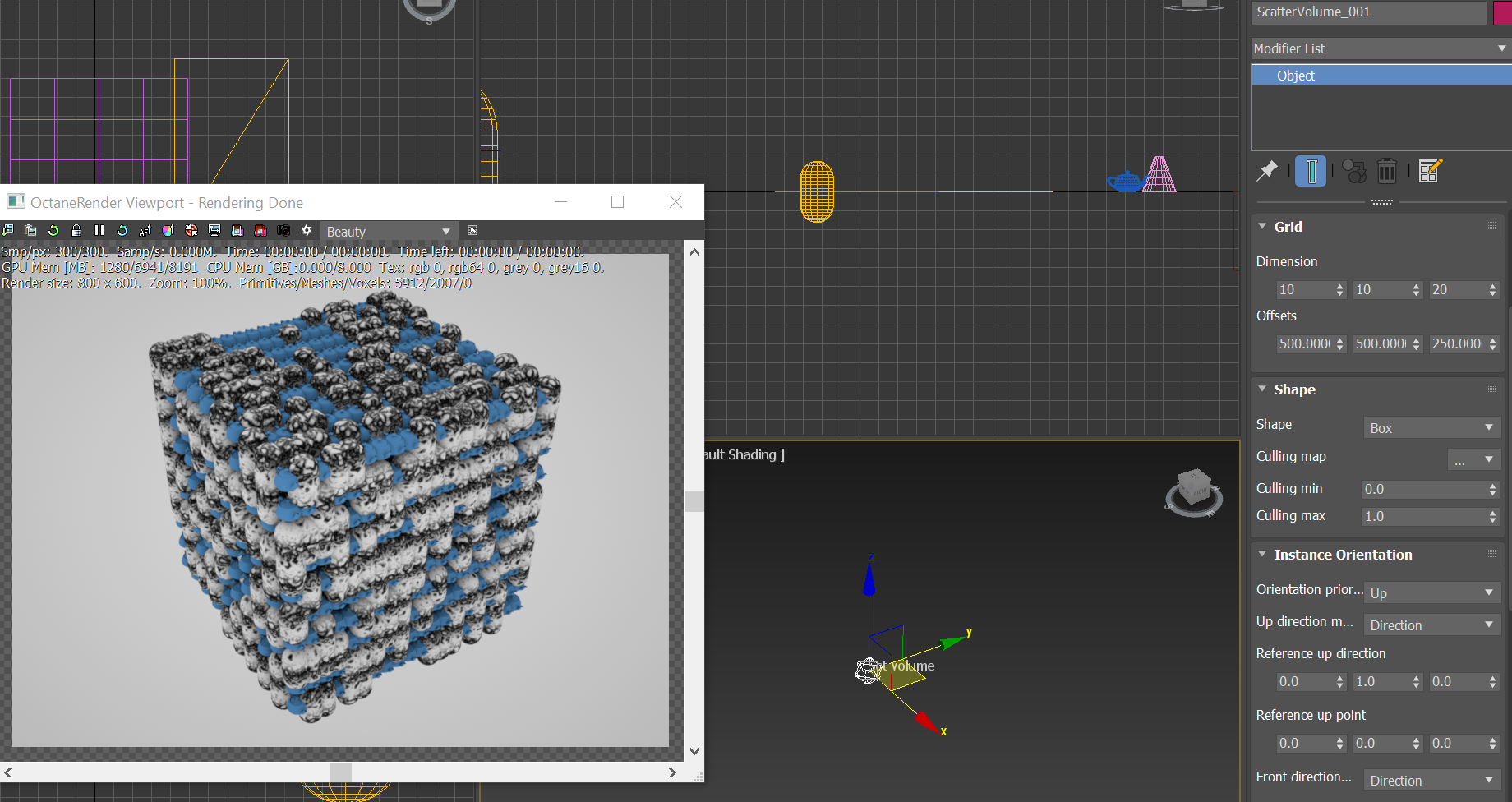

Hi Rik,
Good to know that it works, thanks.

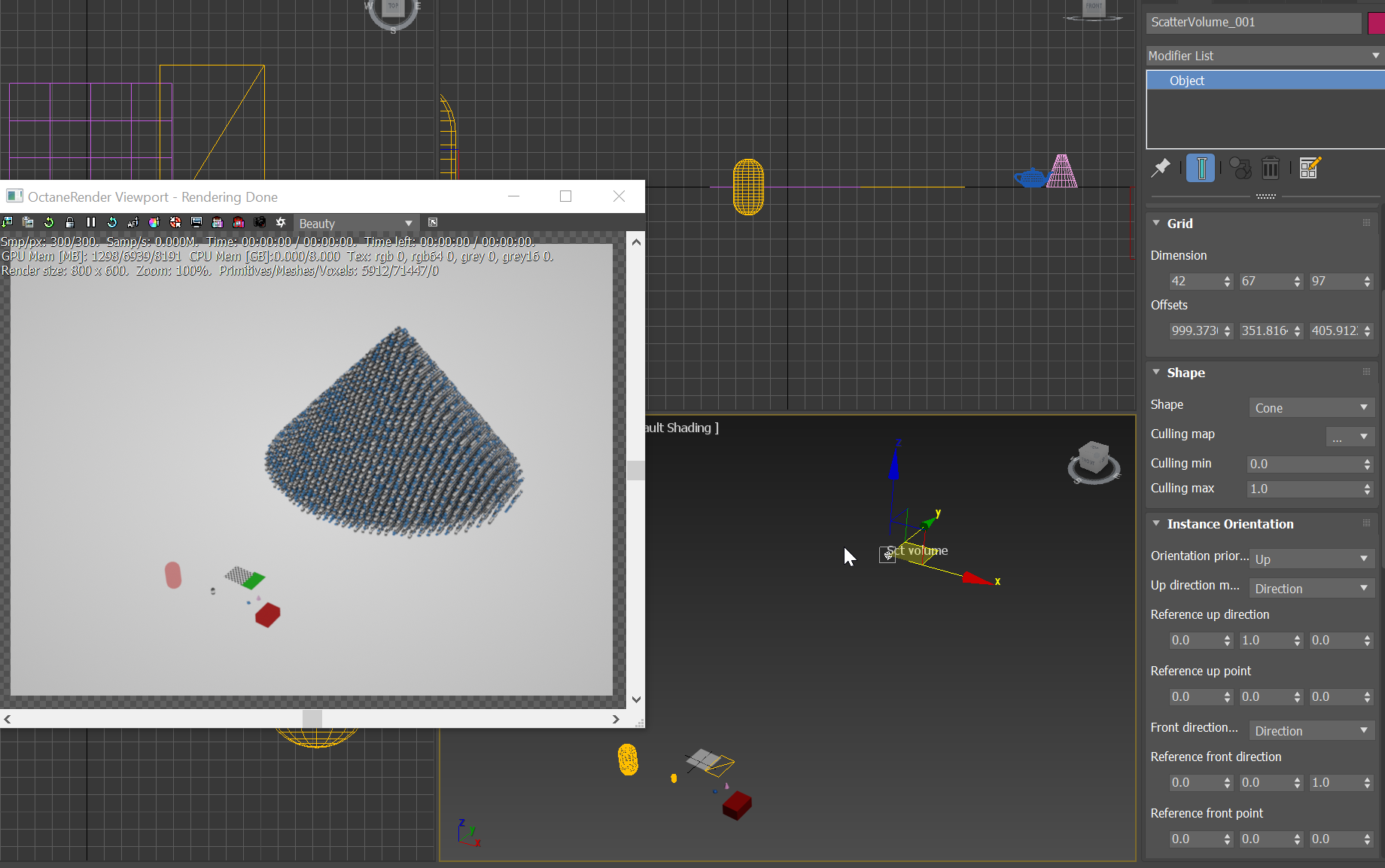

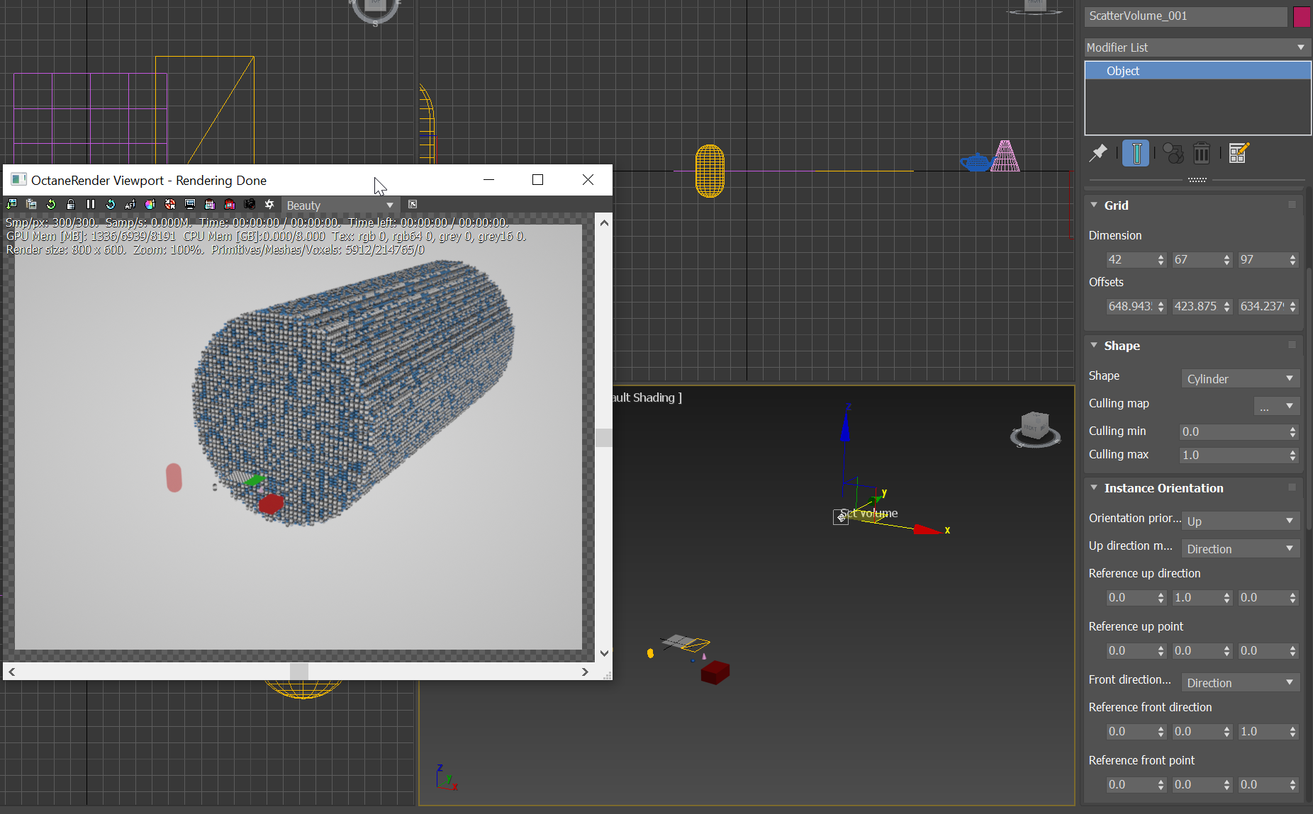

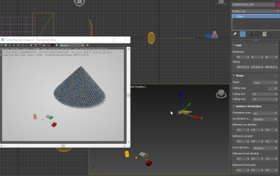

Sorry, no tutorial for those scatter nodes for max.. But the parameters are the same as Stand alone and other plugins.. The final result should be the same.. There is just this node selection that I tried to make in the standard 3dsMax way to select another object..
For the shape, you need to have the 3 Offsets set to non zero ..
To have a 'un-scalled' shape, those offsets should be inverse-proportional to the Dimensions
(for a Box shape with dimensions 10,10,20, to be a cube the offset should be something like 100,100,50)

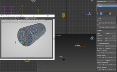

For 'Expand Object Dialogs width [Experimental] ', sorry, that's only from 3dsMax 2018. Previous versions don't have a resizable object panel..

Thanks Neon - think I've figured it out. I now have Octane volume scattered snowflakes! :D
