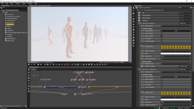

For some reason to make it work I had to copy/paste your objects in a new scene. Did you export the scene from a DCC?
I'll try this, thanks. It was exported from latest Blender buildlinograndiotoy wrote:For some reason to make it work I had to copy/paste your objects in a new scene. Did you export the scene from a DCC?

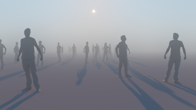

Got it working after removing object with specular material in front of camera. It somehow interferes with this effect.
There is another issue I've found. The fog is causing non aliased edges on objects in fog:

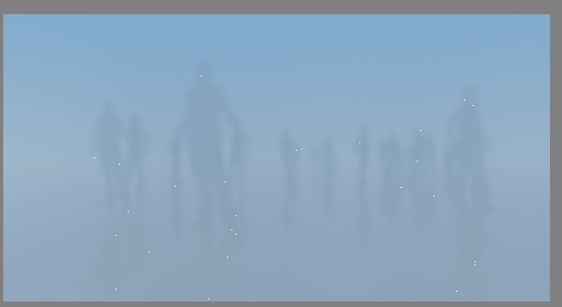

Hi, is the artifact caused by specular objects something like this (the white hot pixels)?J.C wrote:Got it working after removing object with specular material in front of camera. It somehow interferes with this effect.
If so, it should be a bug and we will fix it.

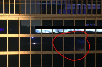

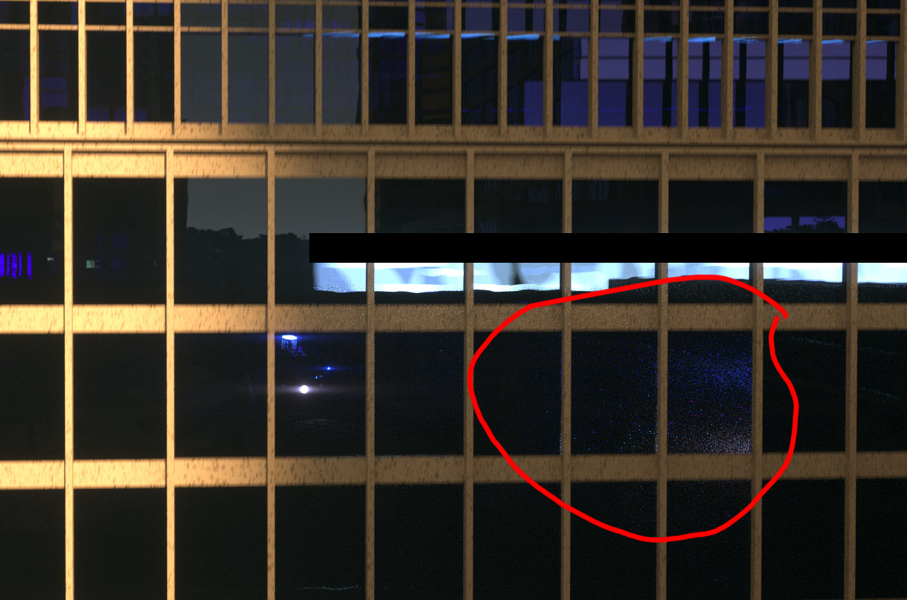

Here is another one the car behind the glass is ok. White lettering reflecting is fine. Everything is fine except internal bounce off the wall and on to the glass. (Circled in red) Please add more auto samples for refraction and reflections especially when light reflects and then refracts. That noise you see is the light inside the building coming from the car on to the inside wall and then refracts through the outside glass . And this is simple AO I cannot imagine diffuse. Not sure who uses diffuse for animations yet. And Iwonder because of your progressive rendering and not bucket rendering the noise will never end no matter how long you render. I noticed most bucket GPU renderers finish clean
