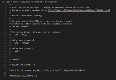

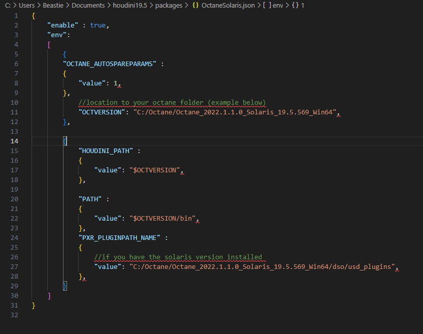

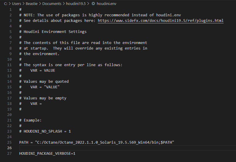

Hi there, I'm having some trouble getting this working on my system.
Info:
Houdini FX 19.5.569 (Py3.7)
Windows 10

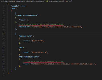

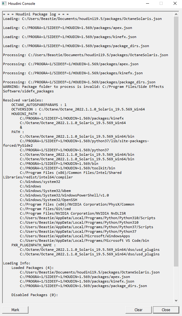

It's the first time I've tried getting the Solaris version of Octane working, so it's possible I'm doing something wrong here. I've set up my houdini.env and the packages JSON files as per the instructions in the post.
I've enabled HOUDINI_PACKAGE_VERBOSE in the env file to see if something isn't coming into Houdini correctly. (see attached image for package log)
Once Houdini is loaded up, the regular (non-Solaris) functionality of Octane seems to work fine, without error.

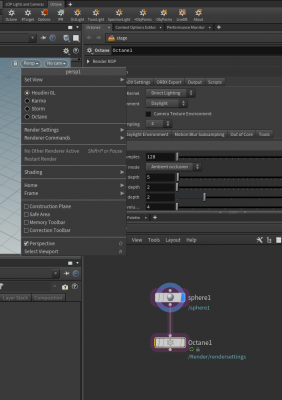

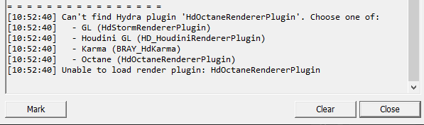

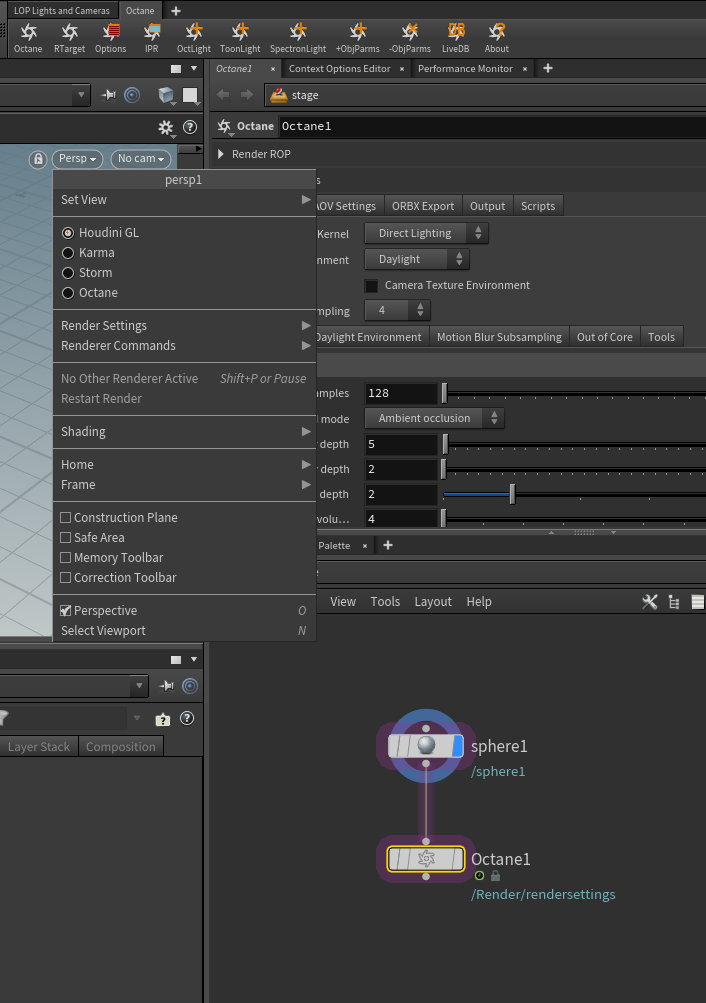

but when I switch into the Solaris workspace and added an Octane node and try to render it just comes up with the following error:
[10:52:40] Can't find Hydra plugin 'HdOctaneRendererPlugin'. Choose one of:
[10:52:40] - GL (HdStormRendererPlugin)
[10:52:40] - Houdini GL (HD_HoudiniRendererPlugin)
[10:52:40] - Karma (BRAY_HdKarma)
[10:52:40] - Octane (HdOctaneRendererPlugin)
[10:52:40] Unable to load render plugin: HdOctaneRendererPlugin
When switching to Octane in the Solaris viewport it does nothing, and afterwards the Octane option just disappears from the list.
Perhaps I'm missing something glaringly obvious here..? Any help would be very greatly appreciated. Thanks!!
Chris

Hey Chris,
Thanks so much for the great post. It helps a lot.
OctaneSolaris require the Python 3.9 version of Houdini.
Would you please try installing SideFX Houdini built with py3.9 and let us know if it still crashes?
Please also disable the plugin loading via the .env since you have assigned the paths with .json.
cheers
