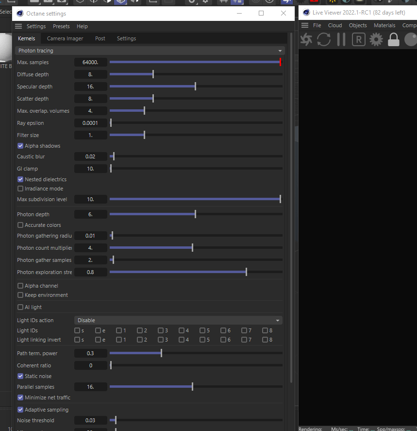

I noticed something while playing with engine settings:
Follow these steps
1. Playing with Photon Tracing kernel and make adjustments
2. Change to a saved preset of Pathtracing
3. Latter I go back to Photo Tracing: surprise, settings are back to default
Don't remember seeing previous versions behaving like this.
So far it feels nice to render with this version.
PS: Are the presets replacing all kernels per state?

Kalua wrote:I noticed something while playing with engine settings:
Follow these steps
I cannot see the behavior as you say. And I don't remember any revisions to cause this. Can you show something for this?
Follow these steps
So yep... I suppose this is how Presets behave now. I mean it's not like it's a terrible thing... I just pointed because it looked different from earlier versions.
I remember It used to save only one kernel per preset? Wasn't it like this it behaved before?

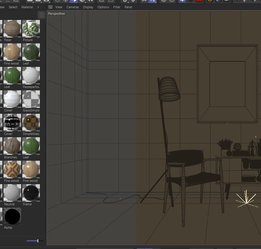

There is another thing I began noticing lately:
A couple of days ago I updated from 2021.1.6 R4 to 2021.1.6 R5 and now 2022.1 XB1.
On both versions I see the material previews take forever to update, If ever...
I Attach an example .gif from a saved scene on 2021.1.6 R4 - which caused no problem in this regard at all.
PS1.:I am rolling back to 2021.1.6 R4 for now.
PS2.: Newly created materials doesn't present this problem.
Preview never finishes to update on 2021.1.6 R5 and 2022.1 XB<br />2021.1.6 R4 works fine

Kalua wrote:There is another thing I began noticing lately:
It's not forever just doesn't do it. It's a bug present when a material is not assigned to some objects. I notified it recently and fixed for next build.
